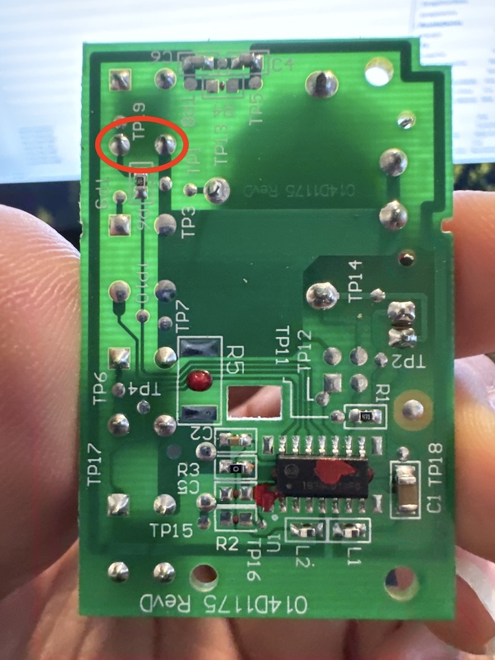

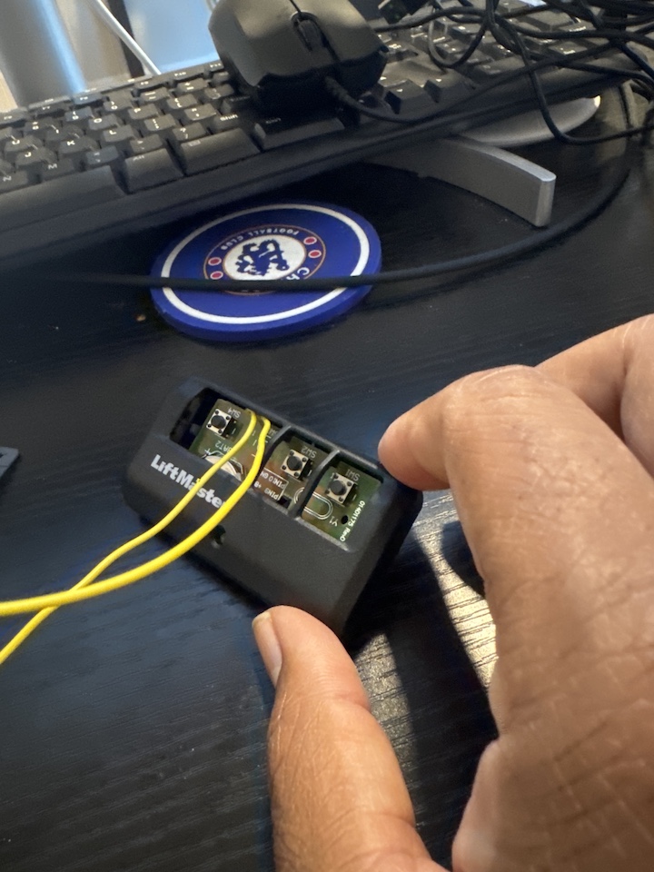

Anyways, this plugin was so essentially vital to my overall automation and security, I had to find a solution. So I copied some of the folks from the HA thread. I grabbed a spare controller from the utility drawer. Ordered a soldering iron ($15 on Amazon; never soldered before in my life), a Zooz GEN16 and some shielded copper wire.
I soldered 2 wires from the underside of the board, where the button that controls my door is connected. I then connected the wires to the Zooz GEN16, set as a momentary switch. I now have control again of my garage door. I'm using a z-wave tilt sensor to let me know the status of the door. Good luck out there folks!

I agree this is a viable solution to the issue. But a couple things to be aware of -
(1) using a remote this way will NOT activate the warning buzzer that you get with the MyQ app or the plugin. So if you have kids or pets that hang out in the garage, be careful.
(2) you need to do some conditional programming, based on the tilt sensor(s), to make sure the door is going to do what you want. Just like using the remote in your car, it's a toggle, not a specific open/close. Papamac's Virtual Garage Door plugin will help here: https://www.indigodomo.com/pluginstore/267/
Lastly, I wouldn't use the word "betrayed" because the library (and plugin) was always based on reverse engineering the protocol. They never promised any API access. However, what they're doing is deliberately "screwing" their customers, so that's how I would classify it. I also will never buy another MyQ based product.
