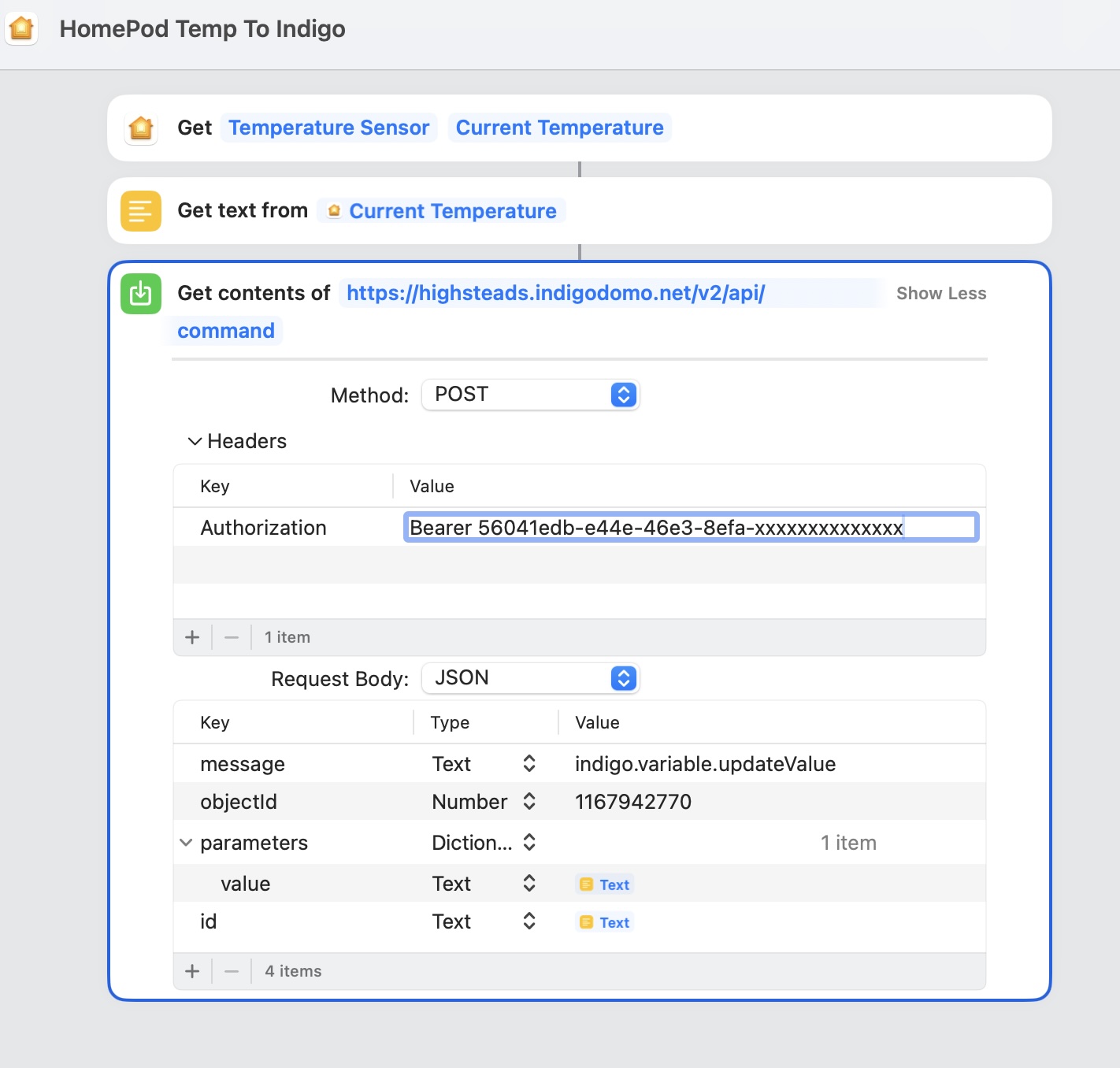

jay (support) wrote:Got it. Those are primarily for security purposes so that you can see any API calls that you might not be expecting. We do understand the clutter if you are doing something that requires some kind of constant communication..
I appreciate the security concern but the log file will get so cluttered trying to find an unexpected API call would be impossible to see anyway. It would be nice to have the option.
jay (support) wrote:One way you might be able to reduce the logging is to attempt to consolidate all those shortcuts into one. I don't know what they do, so that suggestion is just speculation.
I cannot see how to consolidate when every variable update has to call the API.

Still getting my head around all this but so far
Two types, 'indigo.variable.updateValue' (example as above) for temp, humidity, lux need to be polled hence the request to kill the log output and on/off types like my Aqara FP2 motion and door/window sensors using 'indigo.actionGroup.execute' can be triggered by the Home app and doesn't hit the log to much. but also log every time.
