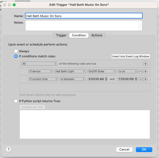

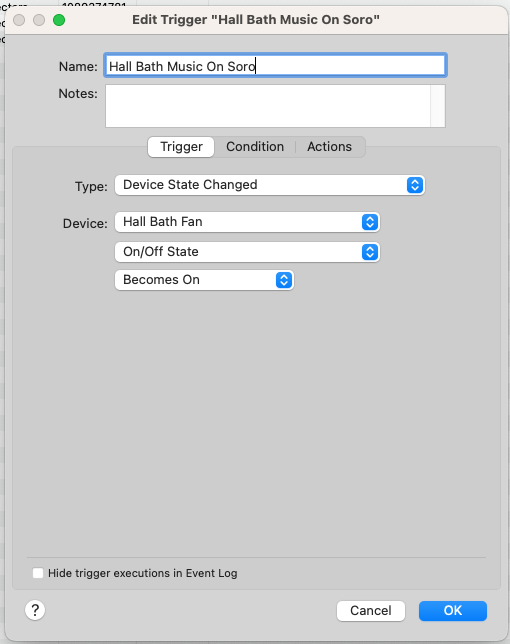

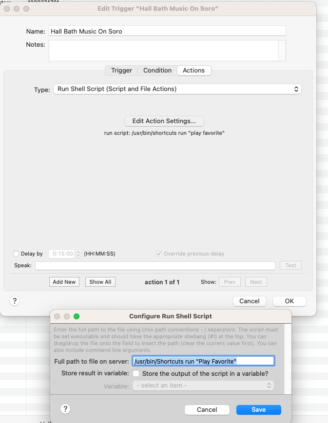

Re: Question on running Shortcuts via Indigo
Like I mentioned it works after an hour but not the first time each day ?
Try adding this to the end of your command:Then look at /tmp/debug.text to see if you captured any output.
>> /tmp/debug.txt 2>&1Re: Question on running Shortcuts via Indigo
I’m not sure what that is supposed to do but I just did it - did not work - if I wait an hour or so and try again it will work and then work all day, log output below - no change from what I usually see…
Are you sure that your Mac's clock is set appropriately? Also, confirm that you have your times set correctly in the conditions tab.
Just checked the clock and it is correct - times in action are also OK.
