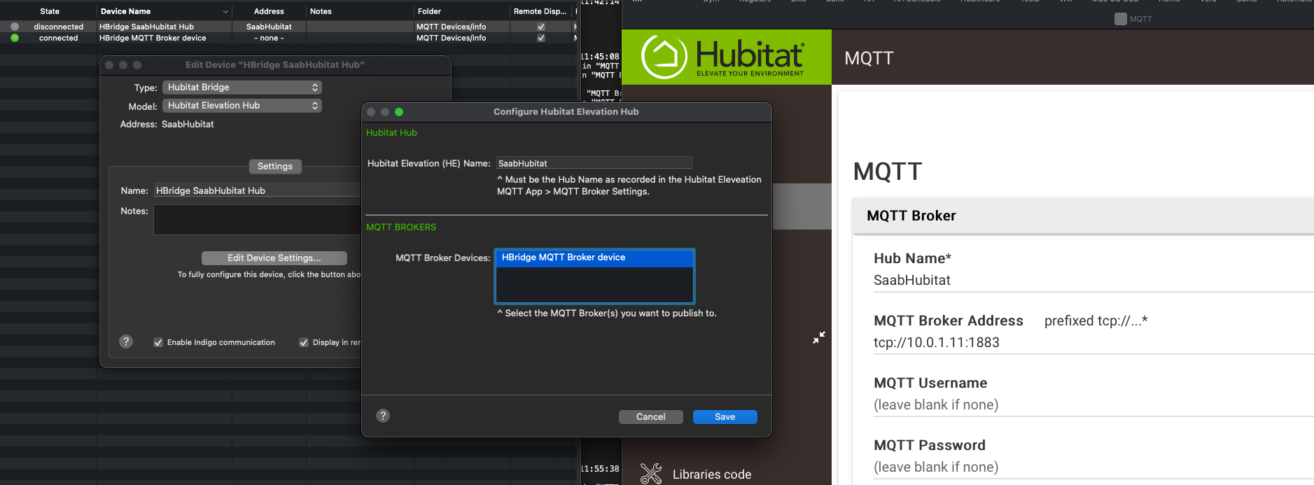

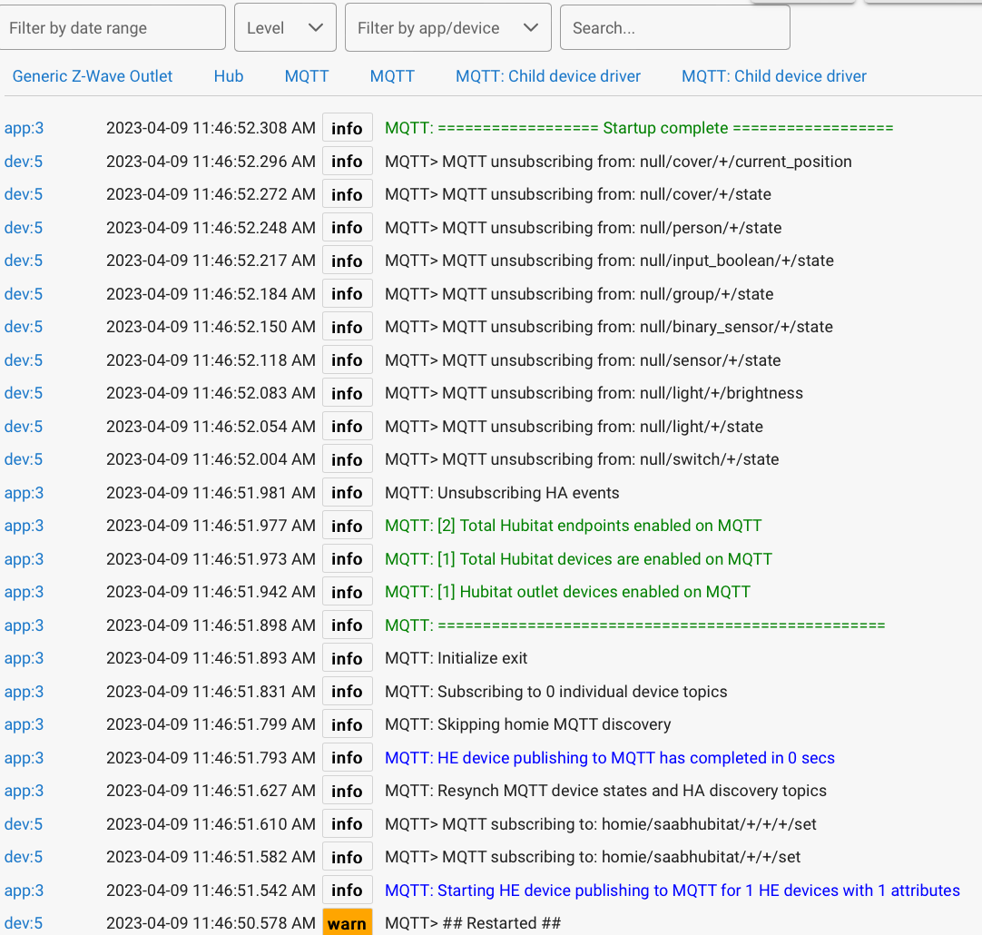

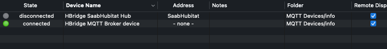

ON the Hubitat side, everything installed/restarted properly. I have one Outlet I'm trying to publish to start with. Here is the MQTT log and a snapshot showing the status in Indigo. It's pretty close to working, but I'm likely missing a setting somewhere. I hope I've given you enough clues-- I understand this is hard to jump into. I can send more screenshots of settings or whatever you need. Thank you for any guidance.

And here is one more screenshot showing that things should probably be connected--- the names and addresses match. (again, the problem is mine-- I've missed something)

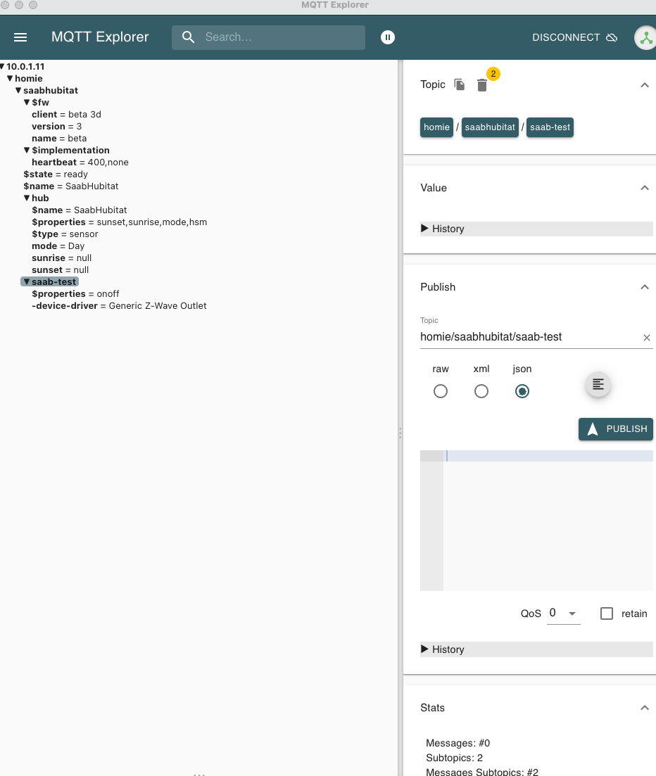

It would be useful to see what MQTT Explorer (available on the App Store or from here) shows on the MQTT Broker.

Thank you for that-- If I'm interpreting this app correctly, it looks like my Hubitat (SaabHubitat) is publishing one device, an outlet (saab-test)-- and that looks correct. But, I would also think that the Hubitat Bridge plugin would have an entry-- and it doesn't seem to-- as it is disconnected. So, I would guess my problem is someplace in an Indigo Plugin setting. This is my first MQTT adventure, so I'm an extreme novice.

Wow. Fixed. My Hubitat is called "SaabHubitat". When that name gets sent to the MQTT Broker, it gets published as "saabhubitat"
Note the letter case change.
I noticed that difference while looking at the data in the MQTT Explorer app -- So, I changed the device name in the Indigo Hubitat Bridge plugin to lower case and I instantly saw the green connected light.
Thank you for pointing me in the right direction. Without your guidance, I would have never caught that. Never.
