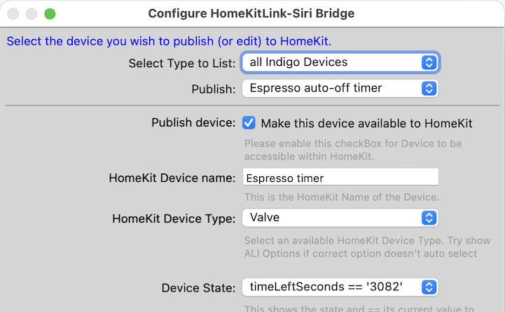

Sorry to keep pestering...
I have decided to try implementing my timer as a valve, as a valve is supposed to support a timer value up to 3600 seconds. I have published the HKLS device as shown in the screenshot below. However, the Home app implements as a switch. Same thing happens if I set it as a LightSensor.
Screenshot 2023-04-04 at 10.12.14.png (118.33 KiB) Viewed 1278 times

berkinet wrote:Sorry to keep pestering...
We don’t support timer values as secondary characteristics (if indeed they exist as a characteristic for Valve)
Typically valve is a On/Off True / False value - which the Active chacteristic.
Valve": {
      "OptionalCharacteristics": [
         "SetDuration",
         "RemainingDuration",
         "IsConfigured",
         "ServiceLabelIndex",
         "StatusFault",
         "Name"
      "RequiredCharacteristics": [
         "Active",
         "InUse",
         "ValveType"
      "UUID": "000000D0-0000-1000-8000-0026BB765291"
This is the timer example - the UI work alone to add support would be big and not really worth it unfortunately. If indeed these optional characteristics can be set at beginning.
Glenn
