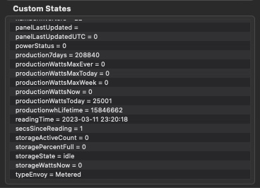

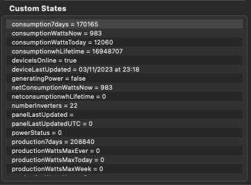

Hi Glenn,
Thanks for the quick response. Sorry I didn't respond sooner but it was my birthday yesterday and I did a "little" celebrating!
I uploaded and installed your updated plugin, but unfortunately, it didn't work. I checked the box that requires a token and put in my serial number and token. I tried creating an Envoy device both with and without generating the panels but still the same result. I enabled debugging and below is the log:

I can ping the Envoy and It's connected via an Ethernet cable. I deleted a couple of the characters in the token above since this is a public forum. The log info repeats about every 3-4 minutes. Sorry I don't have better news but I'm sure you can't really fix the problem until your system gets the update.
Thanks again for trying.
Ralph

Apparently I can email enphase and ask them to update - so will do that as well
https://github.com/Ghawken/IndigoEnphas ... ee/Python3
Hard to be sure regarding endpoints - the ones they give, it would seem others are NOT using - so hopefully these ones I use still exist.
Have added a New Check endpoint Button in Envoy-S Device edit page - there is a button check endpoints
Press this and PM the log - will check all known end points (both with http and https) and then will know what are dealing with.
Re: Enphase Envoy API Update
Here ya go:

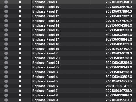

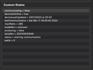

You're getting there!! It created the Envoy device and I can read some of the properties of the device. I'm not able to generate a panel device, however. I clicked on the "Generate Panels" button and the log for that is towards the bottom. I'm running Ventura 10.13.0.1 on my server. The 2 jpegs are the states of the new Envoy device.

********************GENERATE PANELS BUTTON PRESSED*******************************
Mar 11, 2023 at 11:11:00 PM
Enphase Envoy Plugin Debug Found configured device: Envoy
Enphase Envoy Plugin Debug Envoy is enabled.
Enphase Envoy Plugin Debug Envoy: Time Since Device Update = 80
Enphase Envoy Plugin Debug Online: Refreshing device: Envoy
Enphase Envoy Plugin Debug getTheData PRODUCTION METHOD method called.
Enphase Envoy Plugin Debug Create_Headers called for device.name Envoy
Enphase Envoy Plugin Debug Use_token: True
Enphase Envoy Plugin Debug Using Headers: {'Accept': 'application/json', 'Authorization': 'Bearer eyJraWQiOiI3ZDEwMDA1ZC03ODk5LTRkMGQtYmNiNC0yNDRmOThlZTE1NmIiLCJ0eXAiOiJKV1QiLCJhbGciOiJFUzI1NiJ9.eyJhdWQiOiIxMjE5MjkwNzAyMDciLCJpc3MiOiJFbnRyZXoiLCJlbnBoYXNlVXNlciI6Im93bmVyIiwiZXhwIjoxNzEwMDg3NTg4LCJpYXQiOjE2Nzg1NTE1ODgsImp0aSI6IjljZDQxMTgyLWRlNGQtNGM0Ny1iMmY4LTE3OGUyYTIwN2I3OSIsInVzZXJuYW1lIjoicmFscGhAc2FiZW5lLmNvbSJ9.6wG61vsxy1VR_JCwm7M49TV4M2SK-u1OfQB0EN5mQTQ59PbIy1z2altUDNk0rf4OF1-2Q3mVd97v5-7rfdiG-w'}
Enphase Envoy Plugin Debug generate Panels run
Enphase Envoy Plugin Debug Folder ID0
Enphase Envoy Plugin Debug getthePanels Enphase Envoy method called.
Enphase Envoy Plugin Debug getthePanels: Password:070207
Enphase Envoy Plugin Debug ReadTimeout with get Panel Devices:HTTPSConnectionPool(host='10.0.1.75api', port=443): Max retries exceeded with url: /v1/production/inverters (Caused by NewConnectionError('<urllib3.connection.HTTPSConnection object at 0x104ed41f0>: Failed to establish a new connection: [Errno 8] nodename nor servname provided, or not known'))
Enphase Envoy Plugin Debug Result:{'production': [{'type': 'inverters', 'activeCount': 22, 'readingTime': 0, 'wNow': 0, 'whLifetime': 365058}, {'type': 'eim', 'activeCount': 1, 'measurementType': 'production', 'readingTime': 1678594268, 'wNow': 0.0, 'whLifetime': 15846662.983, 'varhLeadLifetime': 0.0, 'varhLagLifetime': 7586918.373, 'vahLifetime': 21160522.861, 'rmsCurrent': 3.928, 'rmsVoltage': 247.813, 'reactPwr': 483.853, 'apprntPwr': 486.73, 'pwrFactor': 0.0, 'whToday': 25001.983, 'whLastSevenDays': 208840.983, 'vahToday': 27793.861, 'varhLeadToday': 0.0, 'varhLagToday': 5832.373}], 'consumption': [{'type': 'eim', 'activeCount': 1, 'measurementType': 'total-consumption', 'readingTime': 1678594268, 'wNow': 1141.757, 'whLifetime': 16948562.339, 'varhLeadLifetime': 4001214.303, 'varhLagLifetime': 1034509.392, 'vahLifetime': 20375041.72, 'rmsCurrent': 10.675, 'rmsVoltage': 247.908, 'reactPwr': -266.717, 'apprntPwr': 1320.828, 'pwrFactor': 0.86, 'whToday': 11915.339, 'whLastSevenDays': 170287.339, 'vahToday': 14000.72, 'varhLeadToday': 2727.303, 'varhLagToday': 453.392}, {'type': 'eim', 'activeCount': 1, 'measurementType': 'net-consumption', 'readingTime': 1678594268, 'wNow': 1141.757, 'whLifetime': 0.0, 'varhLeadLifetime': 4001214.303, 'varhLagLifetime': -6552408.981, 'vahLifetime': 20375041.72, 'rmsCurrent': 6.747, 'rmsVoltage': 247.86, 'reactPwr': 217.136, 'apprntPwr': 1672.349, 'pwrFactor': 0.68, 'whToday': 0, 'whLastSevenDays': 0, 'vahToday': 0, 'varhLeadToday': 0, 'varhLagToday': 0}], 'storage': [{'type': 'acb', 'activeCount': 0, 'readingTime': 0, 'wNow': 0, 'whNow': 0, 'state': 'idle'}]}
Enphase Envoy Plugin Debug Saving Values method called.
Enphase Envoy Plugin Debug State Image Selector:SensorOff
Enphase Envoy Plugin Debug check thepanels called
Enphase Envoy Plugin Debug ReadTimeout with get Panel Devices:HTTPSConnectionPool(host='10.0.1.75api', port=443): Max retries exceeded with url: /v1/production/inverters (Caused by NewConnectionError('<urllib3.connection.HTTPSConnection object at 0x105199cf0>: Failed to establish a new connection: [Errno 8] nodename nor servname provided, or not known'))
********************CREATE ENVOY DEVICE*****************************
Mar 11, 2023 at 11:05:30 PM
Enphase Envoy Plugin Debug deviceStartComm() method called.
Enphase Envoy Plugin Starting Enphase/Envoy device: new device
Mar 11, 2023 at 11:05:47 PM
Enphase Envoy Plugin Debug Get_Serial_Number_called.
Enphase Envoy Plugin Using Serial Number entered manually in device settings.
Enphase Envoy Plugin Debug Found the correct Serial Number. Continuing.
Enphase Envoy Plugin Debug Create_Headers called for device.name new device
Enphase Envoy Plugin Debug ReadTimeout with get Panel Devices:HTTPSConnectionPool(host='10.0.1.75api', port=443): Max retries exceeded with url: /v1/production/inverters (Caused by NewConnectionError('<urllib3.connection.HTTPSConnection object at 0x105199d80>: Failed to establish a new connection: [Errno 8] nodename nor servname provided, or not known'))
Mar 11, 2023 at 11:06:25 PM
Enphase Envoy Plugin Debug Found configured device: new device
Enphase Envoy Plugin Debug new device is enabled.
Enphase Envoy Plugin Debug new device: Time Since Device Update = 55
Enphase Envoy Plugin Debug Type of Envoy Checking...: new device
Enphase Envoy Plugin Debug Result:{'production': [{'type': 'inverters', 'activeCount': 22, 'readingTime': 0, 'wNow': 0, 'whLifetime': 365058}, {'type': 'eim', 'activeCount': 1, 'measurementType': 'production', 'readingTime': 1678593985, 'wNow': 0.0, 'whLifetime': 15846662.983, 'varhLeadLifetime': 0.0, 'varhLagLifetime': 7586880.349, 'vahLifetime': 21160484.532, 'rmsCurrent': 3.928, 'rmsVoltage': 247.754, 'reactPwr': 481.402, 'apprntPwr': 486.448, 'pwrFactor': 0.0, 'whToday': 25001.983, 'whLastSevenDays': 208840.983, 'vahToday': 27755.532, 'varhLeadToday': 0.0, 'varhLagToday': 5794.349}], 'consumption': [{'type': 'eim', 'activeCount': 1, 'measurementType': 'total-consumption', 'readingTime': 1678593985, 'wNow': 972.232, 'whLifetime': 16948477.84, 'varhLeadLifetime': 4001192.67, 'varhLagLifetime': 1034509.322, 'vahLifetime': 20374941.714, 'rmsCurrent': 9.713, 'rmsVoltage': 247.869, 'reactPwr': -339.635, 'apprntPwr': 1202.486, 'pwrFactor': 0.81, 'whToday': 11830.84, 'whLastSevenDays': 170202.84, 'vahToday': 13900.714, 'varhLeadToday': 2705.67, 'varhLagToday': 453.322}, {'type': 'eim', 'activeCount': 1, 'measurementType': 'net-consumption', 'readingTime': 1678593985, 'wNow': 972.232, 'whLifetime': 0.0, 'varhLeadLifetime': 4001192.67, 'varhLagLifetime': -6552371.027, 'vahLifetime': 20374941.714, 'rmsCurrent': 5.785, 'rmsVoltage': 247.812, 'reactPwr': 141.768, 'apprntPwr': 1433.589, 'pwrFactor': 0.68, 'whToday': 0, 'whLastSevenDays': 0, 'vahToday': 0, 'varhLeadToday': 0, 'varhLagToday': 0}], 'storage': [{'type': 'acb', 'activeCount': 0, 'readingTime': 0, 'wNow': 0, 'whNow': 0, 'state': 'idle'}]}
Enphase Envoy Plugin Debug Envoy-S Metered Version Found. Continuing.
Mar 11, 2023 at 11:07:46 PM
Enphase Envoy Plugin Debug checkPanelInventory Enphase Panels method called.
Enphase Envoy Plugin Debug getInventoryData Enphase Panels method called.
Enphase Envoy Plugin Debug Inventory Result:[{'type': 'PCU', 'devices': [{'part_num': '800-00625-r02', 'installed': '1621533037', 'serial_num': '202105031948', 'device_status': ['envoy.cond_flags.obs_strs.failure'], 'last_rpt_date': '1678577382', 'admin_state': 1, 'dev_type': 1, 'created_date': '1621533037', 'img_load_date': '1678219759', 'img_pnum_running': '520-00082-r01-v04.40.01', 'ptpn': '540-00142-r01-v04.40.03', 'chaneid': 1627390225, 'device_control': [{'gficlearset': False}], 'producing': False, 'communicating': False, 'provisioned': False, 'operating': False}, {'part_num': '800-00625-r02', 'installed': '1621533041', 'serial_num': '202105034079', 'device_status': ['envoy.cond_flags.obs_strs.failure'], 'last_rpt_date': '1678578142', 'admin_state': 1, 'dev_type': 1, 'created_date': '1621533041', 'img_load_date': '1678219759', 'img_pnum_running': '520-00082-r01-v04.40.01', 'ptpn': '540-00142-r01-v04.40.03', 'chaneid': 1627390481, 'device_control': [{'gficlearset': False}], 'producing': False, 'communicating': False, 'provisioned': False, 'operating': False}, {'part_num': '800-00625-r02', 'installed': '1621533045', 'serial_num': '202105034238', 'device_status': ['envoy.cond_flags.obs_strs.failure'], 'last_rpt_date': '1678577743', 'admin_state': 1, 'dev_type': 1, 'created_date': '1621533045', 'img_load_date': '1678219759', 'img_pnum_running': '520-00082-r01-v04.40.01', 'ptpn': '540-00142-r01-v04.40.03', 'chaneid': 1627390737, 'device_control': [{'gficlearset': False}], 'producing': False, 'communicating': False, 'provisioned': False, 'operating': False}, {'part_num': '800-00625-r02', 'installed': '1621533048', 'serial_num': '202105040692', 'device_status': ['envoy.cond_flags.obs_strs.failure'], 'last_rpt_date': '1678577864', 'admin_state': 1, 'dev_type': 1, 'created_date': '1621533048', 'img_load_date': '1678219759', 'img_pnum_running': '520-00082-r01-v04.40.01', 'ptpn': '540-00142-r01-v04.40.03', 'chaneid': 1627390993, 'device_control': [{'gficlearset': False}], 'producing': False, 'communicating': False, 'provisioned': False, 'operating': False}, {'part_num': '800-00625-r02', 'installed': '1621533057', 'serial_num': '202105034827', 'device_status': ['envoy.cond_flags.obs_strs.failure'], 'last_rpt_date': '1678577984', 'admin_state': 1, 'dev_type': 1, 'created_date': '1621533057', 'img_load_date': '1678219759', 'img_pnum_running': '520-00082-r01-v04.40.01', 'ptpn': '540-00142-r01-v04.40.03', 'chaneid': 1627391249, 'device_control': [{'gficlearset': False}], 'producing': False, 'communicating': False, 'provisioned': False, 'operating': False}, {'part_num': '800-00625-r02', 'installed': '1621533060', 'serial_num': '202105038701', 'device_status': ['envoy.cond_flags.obs_strs.failure'], 'last_rpt_date': '1678577984', 'admin_state': 1, 'dev_type': 1, 'created_date': '1621533060', 'img_load_date': '1678219759', 'img_pnum_running': '520-00082-r01-v04.40.01', 'ptpn': '540-00142-r01-v04.40.03', 'chaneid': 1627391505, 'device_control': [{'gficlearset': False}], 'producing': False, 'communicating': False, 'provisioned': False, 'operating': False}, {'part_num': '800-00625-r02', 'installed': '1621533068', 'serial_num': '202105040735', 'device_status': ['envoy.cond_flags.obs_strs.failure'], 'last_rpt_date': '1678577082', 'admin_state': 1, 'dev_type': 1, 'created_date': '1621533068', 'img_load_date': '1678219759', 'img_pnum_running': '520-00082-r01-v04.40.01', 'ptpn': '540-00142-r01-v04.40.03', 'chaneid': 1627391761, 'device_control': [{'gficlearset': False}], 'producing': False, 'communicating': False, 'provisioned': False, 'operating': False}, {'part_num': '800-00625-r02', 'installed': '1621533075', 'serial_num': '202105032886', 'device_status': ['envoy.cond_flags.obs_strs.failure'], 'last_rpt_date': '1678578018', 'admin_state': 1, 'dev_type': 1, 'created_date': '1621533075', 'img_load_date': '1678219759', 'img_pnum_running': '520-00082-r01-v04.40.01', 'ptpn': '540-00142-r01-v04.40.03', 'chaneid': 1627392017, 'device_control': [{'gficlearset': False}], 'producing': False, 'communicating': False, 'provisioned': False, 'operating': False}, {'part_num': '800-00625-r02', 'installed': '1621533079', 'serial_num': '202105039961', 'device_status': ['envoy.cond_flags.obs_strs.failure'], 'last_rpt_date': '1678577142', 'admin_state': 1, 'dev_type': 1, 'created_date': '1621533079', 'img_load_date': '1678219759', 'img_pnum_running': '520-00082-r01-v04.40.01', 'ptpn': '540-00142-r01-v04.40.03', 'chaneid': 1627392273, 'device_control': [{'gficlearset': False}], 'producing': False, 'communicating': False, 'provisioned': False, 'operating': False}, {'part_num': '800-00625-r02', 'installed': '1621533083', 'serial_num': '202105035570', 'device_status': ['envoy.cond_flags.obs_strs.failure'], 'last_rpt_date': '1678577172', 'admin_state': 1, 'dev_type': 1, 'created_date': '1621533083', 'img_load_date': '1678219759', 'img_pnum_running': '520-00082-r01-v04.40.01', 'ptpn': '540-00142-r01-v04.40.03', 'chaneid': 1627392529, 'device_control': [{'gficlearset': False}], 'producing': False, 'communicating': False, 'provisioned': False, 'operating': False}, {'part_num': '800-00625-r02', 'installed': '1621533087', 'serial_num': '202105037990', 'device_status': ['envoy.cond_flags.obs_strs.failure'], 'last_rpt_date': '1678578111', 'admin_state': 1, 'dev_type': 1, 'created_date': '1621533087', 'img_load_date': '1678219759', 'img_pnum_running': '520-00082-r01-v04.40.01', 'ptpn': '540-00142-r01-v04.40.03', 'chaneid': 1627392785, 'device_control': [{'gficlearset': False}], 'producing': False, 'communicating': False, 'provisioned': False, 'operating': False}, {'part_num': '800-00625-r02', 'installed': '1621533095', 'serial_num': '202105037982', 'device_status': ['envoy.cond_flags.obs_strs.failure'], 'last_rpt_date': '1678577175', 'admin_state': 1, 'dev_type': 1, 'created_date': '1621533095', 'img_load_date': '1678219759', 'img_pnum_running': '520-00082-r01-v04.40.01', 'ptpn': '540-00142-r01-v04.40.03', 'chaneid': 1627393041, 'device_control': [{'gficlearset': False}], 'producing': False, 'communicating': False, 'provisioned': False, 'operating': False}, {'part_num': '800-00625-r02', 'installed': '1621533099', 'serial_num': '202105037474', 'device_status': ['envoy.cond_flags.obs_strs.failure'], 'last_rpt_date': '1678577176', 'admin_state': 1, 'dev_type': 1, 'created_date': '1621533099', 'img_load_date': '1678219759', 'img_pnum_running': '520-00082-r01-v04.40.01', 'ptpn': '540-00142-r01-v04.40.03', 'chaneid': 1627393297, 'device_control': [{'gficlearset': False}], 'producing': False, 'communicating': False, 'provisioned': False, 'operating': False}, {'part_num': '800-00625-r02', 'installed': '1621533103', 'serial_num': '202105034396', 'device_status': ['envoy.cond_flags.obs_strs.failure'], 'last_rpt_date': '1678577177', 'admin_state': 1, 'dev_type': 1, 'created_date': '1621533103', 'img_load_date': '1678219759', 'img_pnum_running': '520-00082-r01-v04.40.01', 'ptpn': '540-00142-r01-v04.40.03', 'chaneid': 1627393553, 'device_control': [{'gficlearset': False}], 'producing': False, 'communicating': False, 'provisioned': False, 'operating': False}, {'part_num': '800-00625-r02', 'installed': '1621533107', 'serial_num': '202105038533', 'device_status': ['envoy.cond_flags.obs_strs.failure'], 'last_rpt_date': '1678577178', 'admin_state': 1, 'dev_type': 1, 'created_date': '1621533107', 'img_load_date': '1678219759', 'img_pnum_running': '520-00082-r01-v04.40.01', 'ptpn': '540-00142-r01-v04.40.03', 'chaneid': 1627393809, 'device_control': [{'gficlearset': False}], 'producing': False, 'communicating': False, 'provisioned': False, 'operating': False}, {'part_num': '800-00625-r02', 'installed': '1621533117', 'serial_num': '202105033489', 'device_status': ['envoy.cond_flags.obs_strs.failure'], 'last_rpt_date': '1678577179', 'admin_state': 1, 'dev_type': 1, 'created_date': '1621533117', 'img_load_date': '1678219759', 'img_pnum_running': '520-00082-r01-v04.40.01', 'ptpn': '540-00142-r01-v04.40.03', 'chaneid': 1627394065, 'device_control': [{'gficlearset': False}], 'producing': False, 'communicating': False, 'provisioned': False, 'operating': False}, {'part_num': '800-00625-r02', 'installed': '1621533119', 'serial_num': '202105039945', 'device_status': ['envoy.cond_flags.obs_strs.failure'], 'last_rpt_date': '1678578124', 'admin_state': 1, 'dev_type': 1, 'created_date': '1621533119', 'img_load_date': '1678219759', 'img_pnum_running': '520-00082-r01-v04.40.01', 'ptpn': '540-00142-r01-v04.40.03', 'chaneid': 1627394321, 'device_control': [{'gficlearset': False}], 'producing': False, 'communicating': False, 'provisioned': False, 'operating': False}, {'part_num': '800-00625-r02', 'installed': '1621533123', 'serial_num': '202105035829', 'device_status': ['envoy.cond_flags.obs_strs.failure'], 'last_rpt_date': '1678577181', 'admin_state': 1, 'dev_type': 1, 'created_date': '1621533123', 'img_load_date': '1678219759', 'img_pnum_running': '520-00082-r01-v04.40.01', 'ptpn': '540-00142-r01-v04.40.03', 'chaneid': 1627394577, 'device_control': [{'gficlearset': False}], 'producing': False, 'communicating': False, 'provisioned': False, 'operating': False}, {'part_num': '800-00625-r02', 'installed': '1621533127', 'serial_num': '202105038152', 'device_status': ['envoy.cond_flags.obs_strs.failure'], 'last_rpt_date': '1678577182', 'admin_state': 1, 'dev_type': 1, 'created_date': '1621533127', 'img_load_date': '1678219759', 'img_pnum_running': '520-00082-r01-v04.40.01', 'ptpn': '540-00142-r01-v04.40.03', 'chaneid': 1627394833, 'device_control': [{'gficlearset': False}], 'producing': False, 'communicating': False, 'provisioned': False, 'operating': False}, {'part_num': '800-00625-r02', 'installed': '1621533137', 'serial_num': '202105038538', 'device_status': ['envoy.cond_flags.obs_strs.failure'], 'last_rpt_date': '1678578129', 'admin_state': 1, 'dev_type': 1, 'created_date': '1621533137', 'img_load_date': '1678219759', 'img_pnum_running': '520-00082-r01-v04.40.01', 'ptpn': '540-00142-r01-v04.40.03', 'chaneid': 1627395089, 'device_control': [{'gficlearset': False}], 'producing': False, 'communicating': False, 'provisioned': False, 'operating': False}, {'part_num': '800-00625-r02', 'installed': '1621533141', 'serial_num': '202105035396', 'device_status': ['envoy.cond_flags.obs_strs.failure'], 'last_rpt_date': '1678577184', 'admin_state': 1, 'dev_type': 1, 'created_date': '1621533141', 'img_load_date': '1678219759', 'img_pnum_running': '520-00082-r01-v04.40.01', 'ptpn': '540-00142-r01-v04.40.03', 'chaneid': 1627395345, 'device_control': [{'gficlearset': False}], 'producing': False, 'communicating': False, 'provisioned': False, 'operating': False}, {'part_num': '800-00625-r02', 'installed': '1621533145', 'serial_num': '202105038348', 'device_status': ['envoy.cond_flags.obs_strs.failure'], 'last_rpt_date': '1678577185', 'admin_state': 1, 'dev_type': 1, 'created_date': '1621533145', 'img_load_date': '1678219759', 'img_pnum_running': '520-00082-r01-v04.40.01', 'ptpn': '540-00142-r01-v04.40.03', 'chaneid': 1627395601, 'device_control': [{'gficlearset': False}], 'producing': False, 'communicating': False, 'provisioned': False, 'operating': False}]}, {'type': 'ACB', 'devices': []}, {'type': 'NSRB', 'devices': []}, {'type': 'ESUB', 'devices': []}]
- states2.jpg (36.14 KiB) Viewed 4280 times
- states1.jpg (36.63 KiB) Viewed 4280 times
Okay - panels may still need Password (which is serial) or may not.
That issue - is a simple typo fixed in 0.5.3
Try that for panels, and if not will need password passed..
Glenn
Glenn
BINGO!!
It generated all 22 panels.
Haven't had a chance to play with the new devices but it looks very promising. I'll let you know how things go over the next few days.
Thanks again. I REALLY appreciate it
Ralph
Ralph
- panel1.jpg (27.4 KiB) Viewed 4304 times
- pane2.jpg (81.17 KiB) Viewed 4304 times
No problem.
[edit]
I Reviewed the code and the potentially not working panel data url ,must be working to create the panels.
So looks like it is working....
Originally panel data was paid for only, then was accessible with account envoy and Serial Number (which is what we used before)
Let me know how you go...
If something seems missing - rerun the endpoint button (now that fixed certificate error) will be more useful. And post
Glenn
[edit]
Glenn
