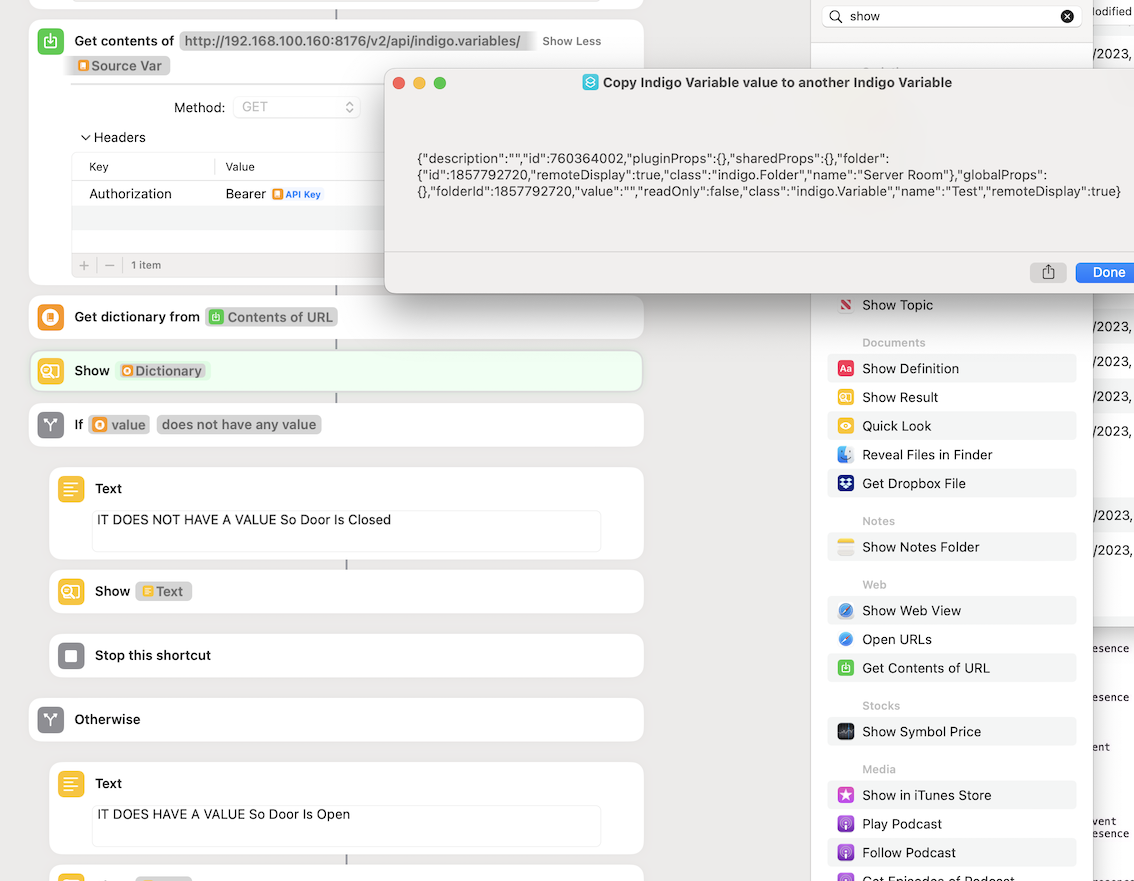

Just tried your demo and decided to use the get a variable bit in a shortcut to open the front door using a loop to re-trigger the lock as it locks after 10 seconds and sometimes it would be helpful to extend the opening by a re-trigger, but stop once the front door contact sensor opens.
I get the variable but the shortcut ‘If’ statement only gives ‘does not have any value’ or ‘does have a value’ as options and sending nothing to blank the Indigo variable is seen as ‘false’ so it always triggers as ‘does have a value’.
Is their another way to get this working?
How do I use a variable value in an IF condition

You need to post a screenshot of your shortcut (or at least the section that gets the variable and attempts to do the IF) in order for use to help.
Re: How do I use a variable value in an IF condition
Screenshot as requested
The variable was blank at this time (- no value - )

Hi Clive, after rereading your post I gave it a try. And spent the next hour trying to figure out what the heck is up with the IF statement.
I've posted another example plugin that shows you how to use the variable value in an IF statement.
Thank you Jay, it makes me feel a bit better that it took you an hour to find a way around Apples roadblocks
