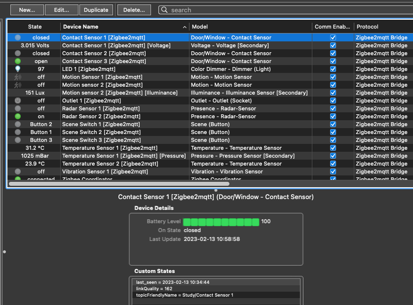

How does the plugin work?
The plugin exposes the Zigbee devices as Indigo devices. This enables the Zigbee device states to be viewed and controlled e.g. turn a power outlet on and off.
Zigbee2mqtt Bridge
Zigbee2mqtt Bridge
Zigbee2mqtt does all the integration and communication with the Zigbee devices - the plugin communicates with Zigbee2mqtt via an MQTT broker. This means that Zigbee2mqtt is responsible for all the complex Zigbee device interactions and the plugin can focus on the device interface with Indigo.
