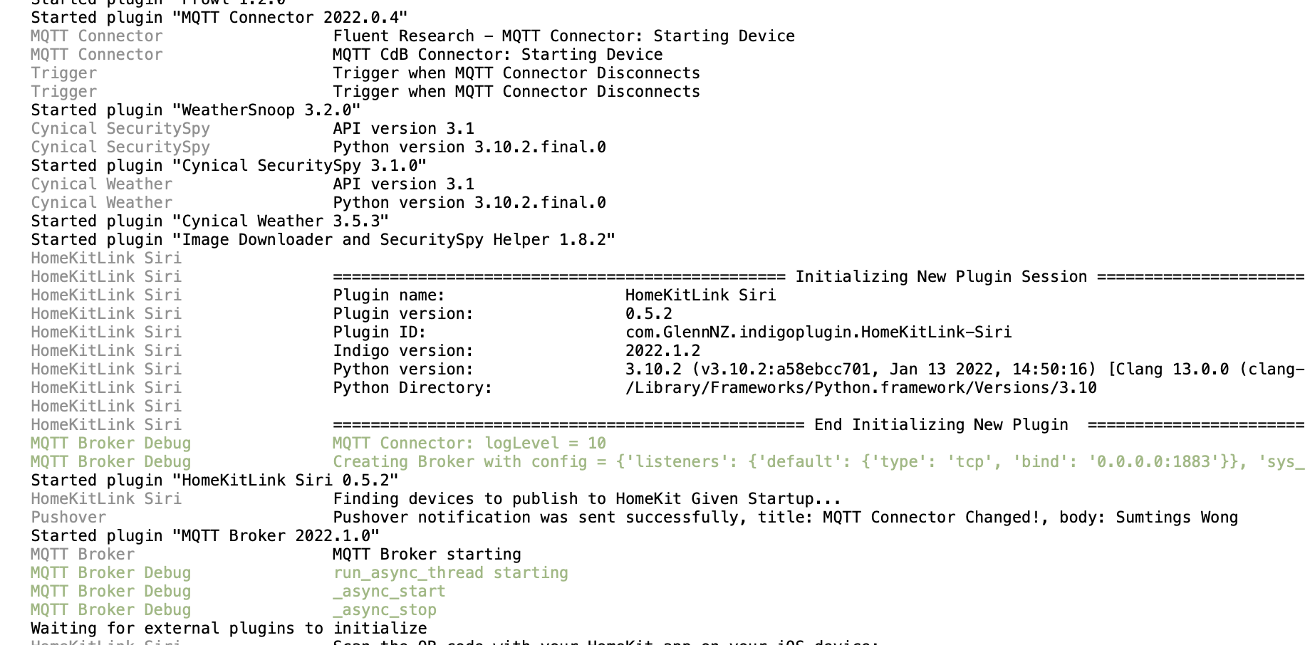

One thing I have noticed is that when I restart my iMac and Indigo launches, the connectors are in "Connection Failed" state. Looking at the log, it appears the MQTT Connector plug-in starts before the MQTT Broker. It would appear the order of the plug-in stating might affect this?

What version of Indigo you running? It shouldn't be doing that. There was a recent change to the plugin API to provide startup order hints.

Well darn, it's doing it on my dev system too. I need to check the hints and then report that to the guys.

OK, so I confirmed the plugins are starting in the correct order. The problem is that it takes longer to spin up the broker than it does a connector device. So the connector is trying to connect before the broker is actually accepting connections. I'll have to figure out a fix for this.
