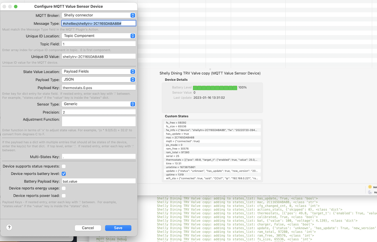

Hoping someone can help my memory, its been a while since using Shims
I am trying to create a generic value sensor and I see the multi states and battery updating, so I knows its reading the message, but I cant find the right value for the Payload Key field as its a nested json message. I want the sensor to show the value in thermostats.pos. is 4.7 below from the debug.

tried lots in last 2 hours and no joy.

Re: Nested json problems
That's a list of dicts, so you need to specify the position in the list. I think that "thermostats.0.pos" is what you need.

Thats what I thought, but still get zero. showing.
Post the complete JSON payload you're getting and I'll set up a test shim for it and see what's going on.
Hmm. This is strange. I could have sworn that code handled mixed dicts and lists. I remember writing code to handle that. But it's not there. Which means I must have written that for some other plugin. But I can't find it. My memory must be playing tricks on me. Sigh.
So, it's not going to work until I can recreate that code and get an update out. Sorry.
Sigh. The code was there, I just didn't recognize it. You want to use "thermostats.[0].pos". I needed to use the brackets to signify a list index because a bare number is a valid key in a dict.

Post by siclark »
So funnily enough I had seen that syntax whilst looking at how to struture some commands to publish on the HA boards, had tried it on the device, but not gone back to check. But yes, that is now working. Thanks.
