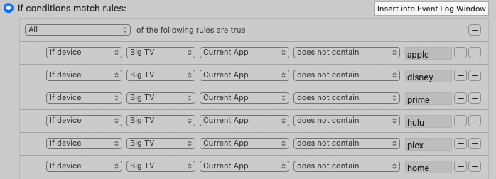

First, thanks for this plugin. I use it every day and it's quite reliable. I have a very reliable trigger that checks to see if I'm NOT using any channel:
And that works to let Indigo kick off setting the input to my PlayStation using the Yamaha receiver plugin.

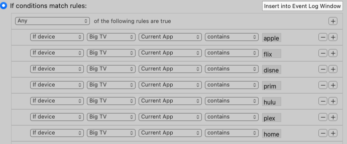

But dang, there's one thing I can't figure out. When I'm going the OTHER way, using one of these channels, this equally kludgy trigger does NOT work:
and I can't figure any other way to make this plugin notice that what's happening on the tv has changed in order to use the Yamaha plugin to change the input. To be clear, I need to trigger an action on the Yamaha plugin, not in Roku, but Roku is what would kick it off.
Unfortunately, there's no way to capture input change actions besides "has any change" as far as I know. The plugin can tell Indigo it has changed, but seems to be unable to tell HOW it has changed, even though the plugin is aware of what the input is.
Or am I missing something?

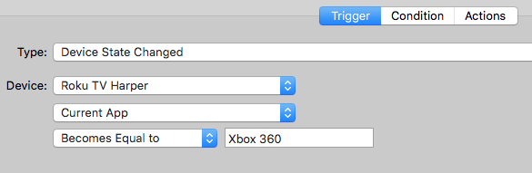

Current App will also reflect whatever name you gave an input.
I have a trigger for HDMI 1, which is "Xbox 360" <- Because I'm old school.
The trigger is: Current App becomes equal to "Xbox 360"
If you have your Roku TV turned to your playstation, when you select the dropdown to "Current App" it will autopopulate with the current app / input you have the TV set to.
Do the same trigger in reverse "Becomes not equal to" to fire when you switch away from the playstation.
I hope that helps.
I hope that helps.

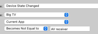

Ahhh, Now I see my problem: My switching takes place on my amp.
And I never noticed that "AV receiver" was in the app list. Never occurred to me to look in the app list for inputs!
I'll think this through. Maybe I have to trigger based on changes on the amp, which is controlled via the Yamaha plugin.
Thanks!
