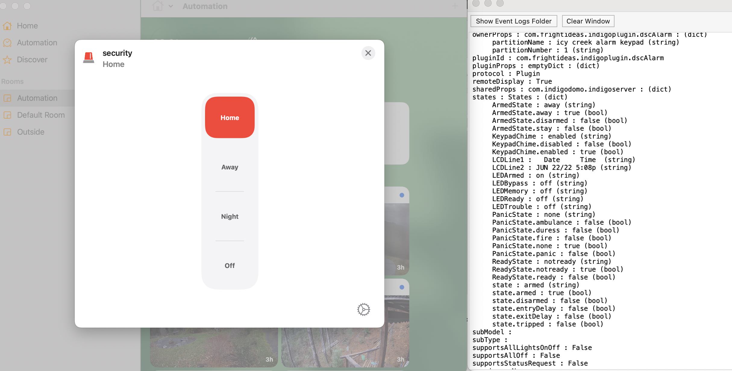

okay...I've run a whole lot of tests.
I think one issue is present:
- HomeKit displays an armed status of 'Home' when Indigo reports the DSC armed status 'Away'. Attached screenshot shows homekit, and and a print of DSC states.
further debugging is made more complex because a DSC configuration issue means the system will always arm to 'Away' regardless of whether 'Away' or 'Home' is requested (regardless of the interface used).

Hi
To fix this I really need some logging from HomeKitLink Plugin. (as I mention above)
Set device to debug in pluginConfig and change state a few times. Should log before and after states which I can use to fix.
