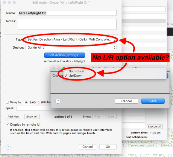

Re: Daikin Wifi controller released for 2022.1/Python 3
Hi Neil!
Still seems to be an issue with L/R action group - there's no option in the configuration for L/R - only U/D (see marked-up screen shot attached).
The debug that this action returns is
and the L/R remains unchanged on the unit. The L/R "no motion" action also has no effect on the unit.
mclass
Action Group Alira Left/Right On
Daikin Wifi Controller Debug /aircon/set_control_info?pow=1&mode=4&stemp=24.0&shum=0&f_rate=A&f_dir_LR=S
Daikin Wifi Controller Debug http://10.10.15.211/aircon/set_control_info?pow=1&mode=4&stemp=24.0&shum=0&f_rate=A&f_dir_LR=S
Daikin Wifi Controller Debug [['ret', 'OK'], ['pow', '1'], ['mode', '4'], ['stemp', '24.0'], ['shum', '0'], ['adv', '13'], ['dt1', '23.0'], ['dt2', 'M'], ['dt3', '26.0'], ['dt4', '24.0'], ['dh1', '0'], ['dh2', '0'], ['dh3', '0'], ['dh4', '0'], ['dhh', '0'], ['alert', '16'], ['f_rate', 'A'], ['dfr1', 'A'], ['dfr2', 'A'], ['dfr3', 'A'], ['dfr4', 'A'], ['dfr6', '3'], ['dfrh', '0'], ['f_dir_ud', '0'], ['f_dir_lr', 'S'], ['ndfd1', '00'], ['ndfd2', '00'], ['ndfd3', '00'], ['ndfd4', '0S'], ['ndfd6', '00'], ['ndfdh', '00'], ['ret', 'OK'], ['htemp', '23.0'], ['hhum', '35'], ['otemp', '12.0'], ['err', '0'], ['cmpfreq', '38'], ['mompow', '17']]
Daikin Wifi Controller Debug ret=OK,adv=13
Daikin Wifi Controller Daikin Alira: set fan direction LR to S
Daikin Wifi Controller Debug [['ret', 'OK'], ['pow', '1'], ['mode', '4'], ['stemp', '24.0'], ['shum', '0'], ['adv', '13'], ['dt1', '23.0'], ['dt2', 'M'], ['dt3', '26.0'], ['dt4', '24.0'], ['dh1', '0'], ['dh2', '0'], ['dh3', '0'], ['dh4', '0'], ['dhh', '0'], ['alert', '16'], ['f_rate', 'A'], ['dfr1', 'A'], ['dfr2', 'A'], ['dfr3', 'A'], ['dfr4', 'A'], ['dfr6', '3'], ['dfrh', '0'], ['f_dir_ud', '0'], ['f_dir_lr', 'S'], ['ndfd1', '00'], ['ndfd2', '00'], ['ndfd3', '00'], ['ndfd4', '0S'], ['ndfd6', '00'], ['ndfdh', '00'], ['ret', 'OK'], ['htemp', '23.0'], ['hhum', '35'], ['otemp', '12.0'], ['err', '0'], ['cmpfreq', '38'], ['mompow', '17'], ['ret', 'OK'], ['curr_day_heat', '0/0/0/0/0/0/0/0/0/0/0/0/0/0/0/0/0/0/0/0/0/0/0/0'], ['prev_1day_heat', '0/0/0/0/0/0/0/0/0/0/0/0/0/0/0/0/0/0/0/0/0/0/0/0'], ['curr_day_cool', '0/0/0/0/0/0/0/0/0/0/0/0/0/0/0/0/0/0/0/0/0/0/0/0'], ['prev_1day_cool', '0/0/0/0/0/0/0/0/0/0/0/0/0/0/0/0/0/0/0/0/0/0/0/0'], ['ret', 'OK'], ['s_dayw', '3'], ['week_heat', '0/0/0/0/0/0/0/0/0/0/0/0/0/0'], ['week_cool', '0/0/0/0/0/0/0/0/0/0/0/0/0/0'], ['ret', 'OK'], ['curr_year_heat', '0/0/0/0/0/0/0/0/0/0/0/0'], ['prev_year_heat', '0/0/0/0/0/0/0/0/0/0/0/0'], ['curr_year_cool', '0/0/0/0/0/0/0/0/0/0/0/0'], ['prev_year_cool', '0/0/0/0/0/0/0/0/0/0/0/0']]
mclass
- Screenshot 2022-06-08 at 11.32.41 am.png (216.25 KiB) Viewed 3905 times
