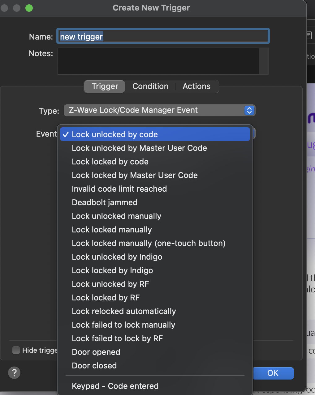

Have you tried using the ZWave Lock Manager specific triggers? Not the generic device changed?
Screen Shot 2022-04-21 at 4.04.47 PM.png (428.77 KiB) Viewed 3281 times

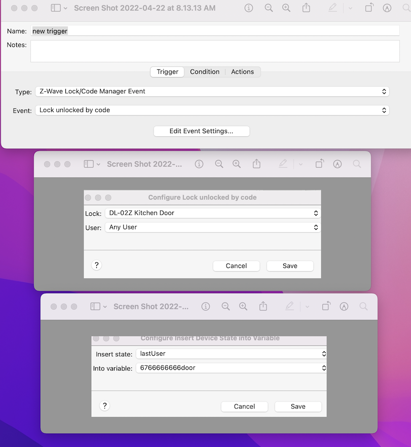

jltnol
Posts: 1162
Re: Lock Triggers
Post by jltnol »
Again, not sure how else to populate the variable via the GUI, but these are the settings I'm using. It only populates the previous user, not the current user. I can easily create a single trigger for a single user, but I've got 12 codes and 2 doors so that means 24 triggers to accomplish what I'm trying to do. I've given the time delay issue consideration, but do find it odd that the custom state is right, but the GUI isn't.
Screen Shot 2022-04-22 at 8.14.34 AM.png (320.04 KiB) Viewed 3169 times
howartp
Posts: 4559
Location: West Yorkshire, UK
Re: Lock Triggers
Post by howartp »
Apologies to you both.
I’ve just realised I’m firing your trigger before I’ve updated the state, so it’s my fault you’re getting wrong state value in variable.
I’ll sort asap.
