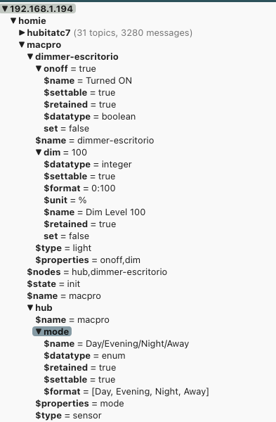

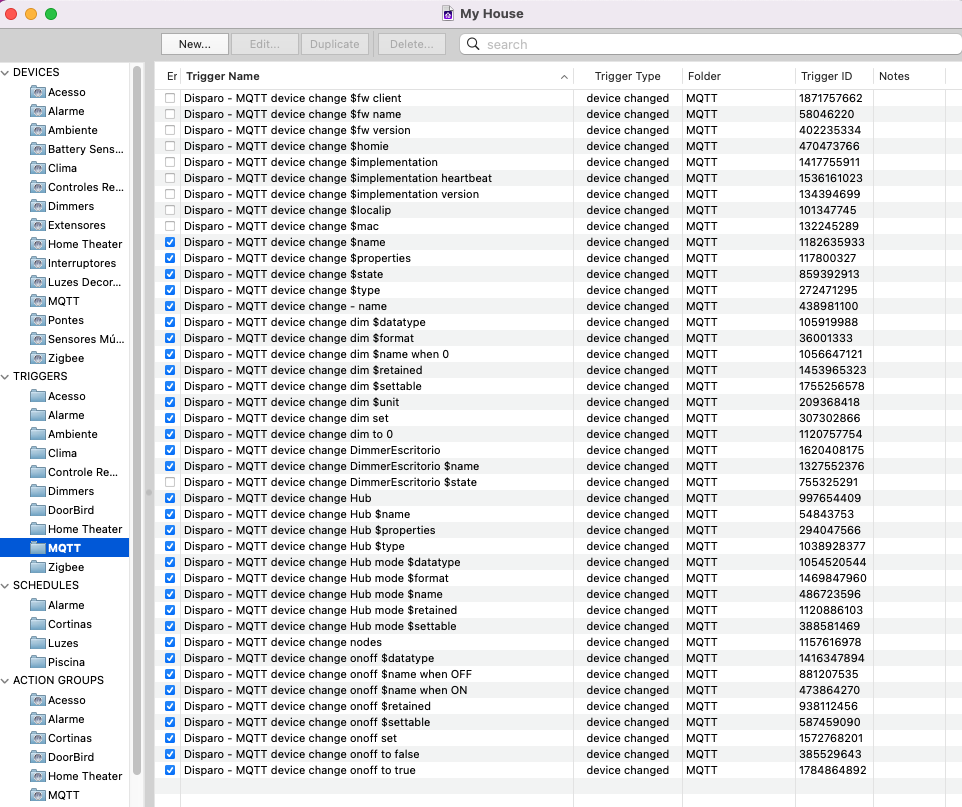

Below are two screen grabs: a) of the topic structure and b) the incredible amount of triggers I have defined in order to have it in MQTT Explorer.

a) b)

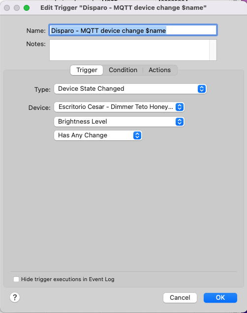

Re: Need help (again) defining MQTT Connector triggers
Thanks once again for your help.

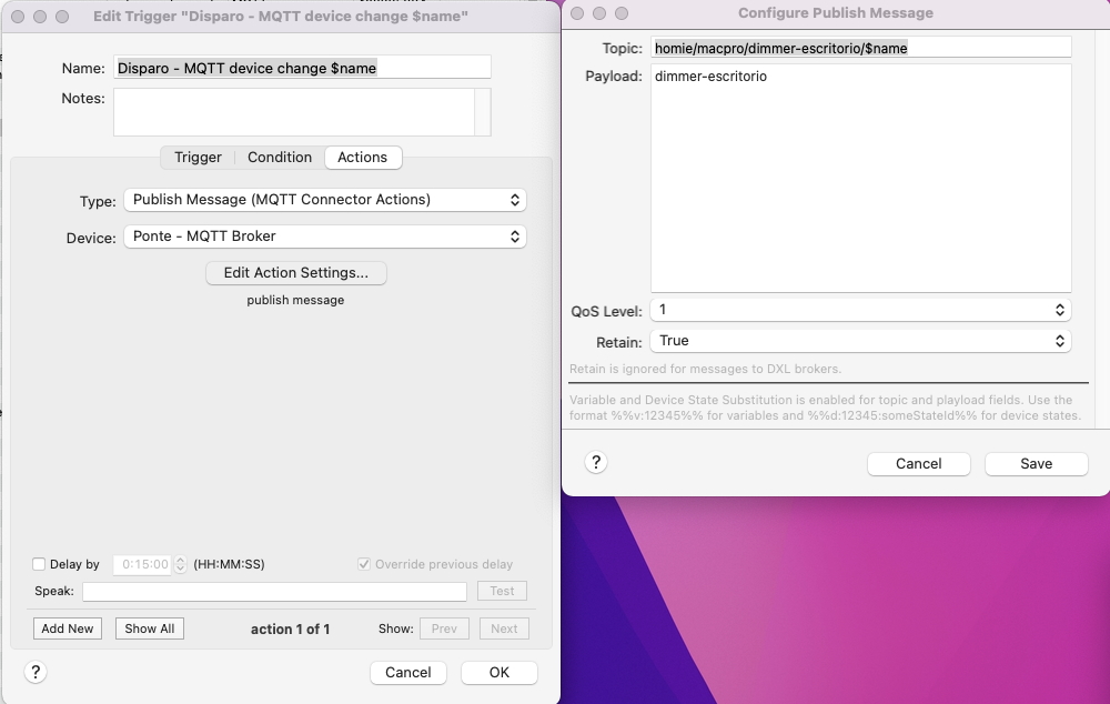

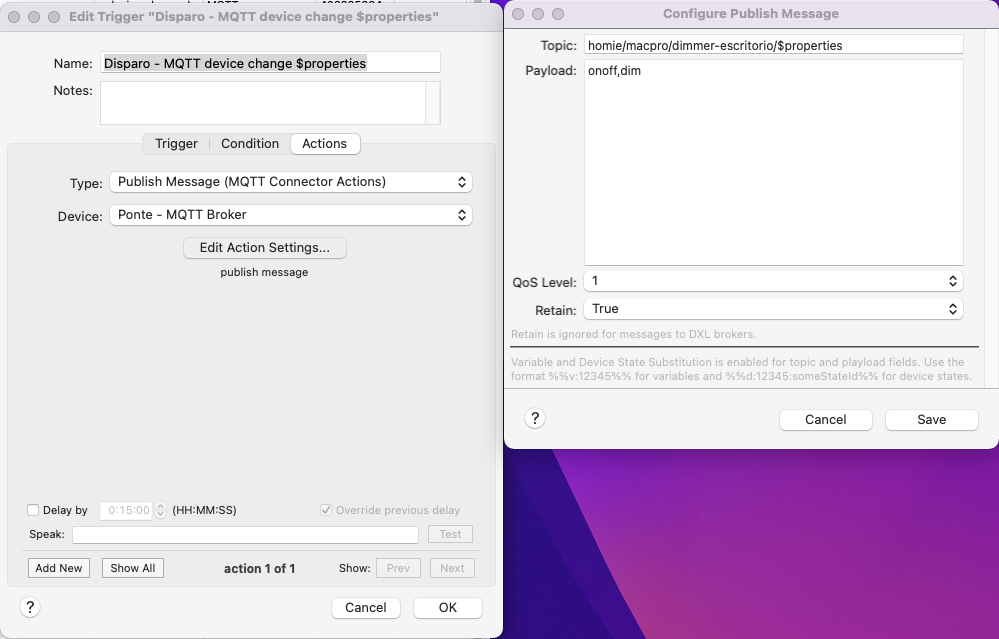

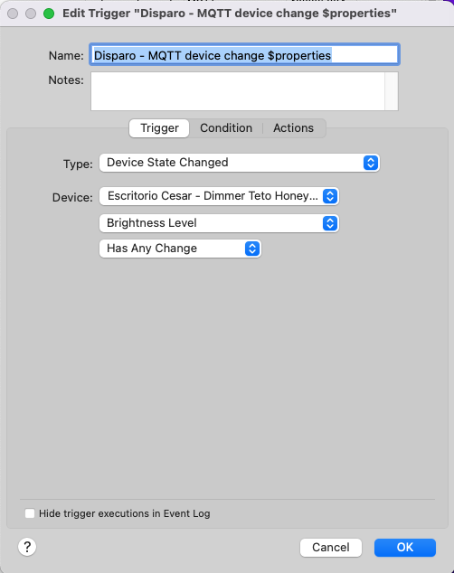

The screen grabs below show two different Triggers I defined (among the 30+), showing the publishing of the TOPIC (dimmer-escritorio) and a sub-topic ($properties). The other 30+ triggers are similar to the sub-topic one, the only difference is the name of the sub-topic and the contents of the payload.
Disclaimer: I will try to order the screen grabs as expected, but with this Forum's attachment feature, you never know how they will end up showing...
We won't be needing to touch the other side of things, as the duo comprised of the xAPPO/MQTT App and Driver + the Hubitat Plugin in the Indigo Plugin store take care of the integration from HE to Indigo, and that part is working very well.FlyingDiver wrote:Publishing Indigo devices to HE via MQTT
Yes, please refer to screen grabs below to see what is being done.FlyingDiver wrote:Are you using the MQTT Connector "Publish Message" action?

OK, I think I understand what's going on now.
First, you don't need a trigger for every topic. You only need a trigger for each state of the device that actually changes. Things like $name and $property don't change, so you'll never need to trigger on them. The only things that change on a standard dimmer device is the Brightness and On/Off state. So those would be the only triggers needed. You probably only need to send the metadata once on startup, or maybe once periodically for device discovery. I didn't see anything about that in the Homie docs I was looking at. I would probably use an Action Group for each device that sends all the metadata.
I would also use a single action group for the variable data for each device, and call that action group from all triggers for that device.
This would be so much easier in a script, but unfortunately even an external (background) script can't get device changed notifications. So it'll have to be a plugin. I'm going to see if I can put this into the Connector plugin as an alternative to the templates there now. It'll be a separate list of devices to publish Homie messages for.
Can you send (or post here) a TEXT list of all the messages you're sending for the one device you have implemented. I need the topic and the payload for each.

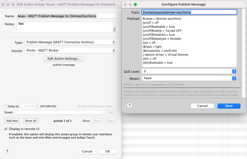

Does the screen grab below show the correct way to set the single action group for discovery purposes? I'm sorry, I don't quite know how to handle multiple sub-topics in MQTT Connector...FlyingDiver wrote:I would probably use an Action Group for each device that sends all the metadata.

Actually, that's just about completely wrong. Sorry. It's one action per topic, and you put multiple actions in the action group. See the "Add new" button in the lower left of the dialog box? So, the first action would be to publish a message with the topic "homie/macpro/dimmer-escitorio/$name" and the payload "dimmer-escitorio". The second would be "homie/macpro/dimmer-escitorio/$settable" with payload "true". And so on. Note that there's no leading "/" in the topics. This is not a file path name.
Also, you don't send a topic ending in "/set". That's for commanding the device to turn on or off. You're not doing that.
I really think you would be better off waiting for Autolog to get the plugin further along, rather than trying to reproduce what the plugin is going to do with discrete Indigo actions.
