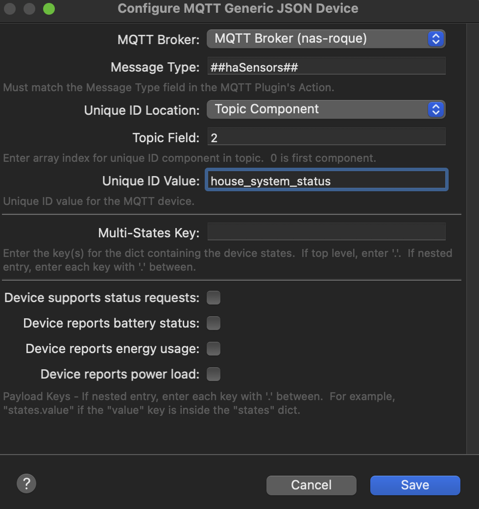

So, trying to configure the device as such:
Device type: Generic JSON
Screen Shot 2021-10-18 at 9.30.08 AM.png (50.45 KiB) Viewed 2007 times
What am I doing wrong?
Thank you!!
JP

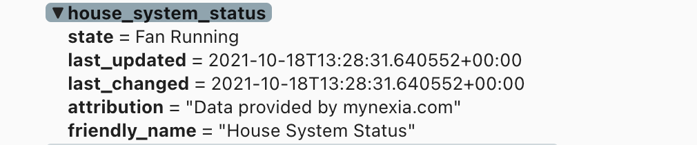

Screen Shot 2021-10-18 at 9.36.23 AM.png (163.38 KiB) Viewed 2007 times
Re: Getting value from JSON into device
It doesn't look like you're showing the complete topic string there. It easier to see what's going on if you configure the MQTT Connector plugin to subscribe to the topics you want, then put it in debug level logging so it logs the topics and payloads.

This is from the debug mgs and exactly the info I would like to collect via a Shims device:
processMessages: '##haSensors##' homeassistant/sensor/house_system_status/state -> System Idle
is this enough to point me in the right direction?
JP
From that, it looks like the payload for that topic is NOT a JSON string, but a plain text string. I'm not sure the Shims plugin can deal with that the way you want. Is there any way to get HA to send actual JSON?
