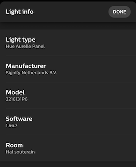

Thanks for building this great plugin! I have recently got a Hue Aurelle panel, which is not yet supported. Attached a screenshot of the app, for the light info.
Or, can I amend the plugin myself? If so, what 'type' of Hue light would this be?
Kind regards, Gerrit Jan

update: Added the model to the 'kAmbianceDeviceIDs' in supportedDevices.py, reloaded the plugin and this basically seems to do the trick. Can add the Aurelle and fully control it.
Aurelle panels are available in three sizes, adding support for them seems only a matter of adding the correct model ID's...

Log entry at plugin load: "The "Hue Aurelle hal onderhuis" device has an unrecognized model ID of "3216131P6". Hue Lights plugin does not support this device."
