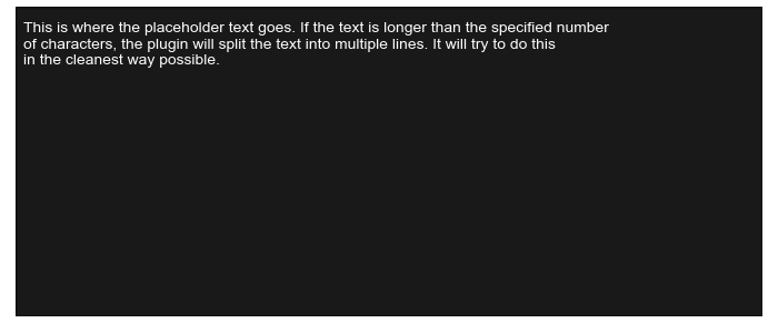

The Matplotlib plugin has a Multiline Text Device that generates image files of long strings. It doesn't automatically detect line breaks--rather it splits the text based on a number of characters listed in the device's configuration settings.
