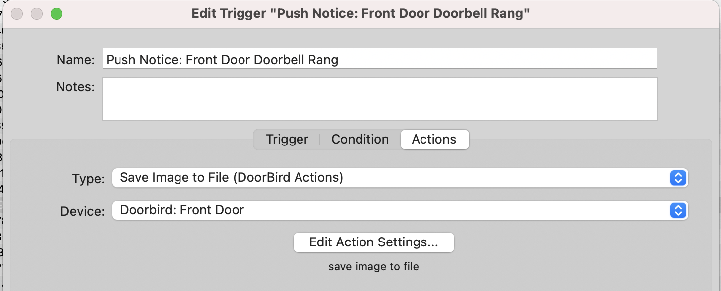

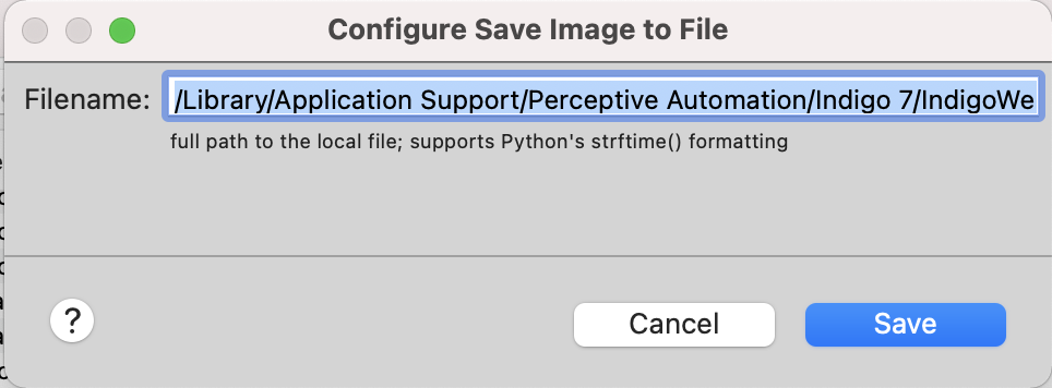

I modified version 1.0 of the plugin to add an action "Save Image to File" that, as the name suggests, saves a jpg image snapshot from the doorbird. I use this for various pushover notifications. If you want to incorporate this into the official plugin, what's the easiest way for me to get the changes to you? I am not a professional programmer and I usually mess stuff up when I try to use GitHub...

Thanks rapamatic, great idea. I'll send you a PM with a Dropbox link if that works?

I've added this functionality to the 1.2.0 version of the plugin in the Plugin Store. Thanks again rapamatic for the great idea and supplying the code :D .

Thanks for adding this in Pete - it's working great for me!
