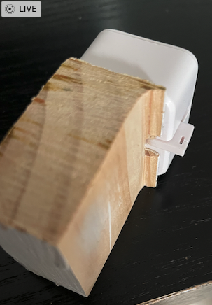

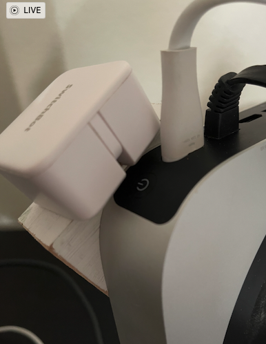

Here is how to connect the switchbot bot to a mac mini
You need a block of wood broad enough to hold the bot. Attach the bot to the wood as shown with a double sticky tape
Then put a double sticky tape on the bottom of the flat side of the wood and adjust to the top of the mac mini so that it presses the button when it is set to on.
Set the "hold" time for the bot to 4 seconds. That allows it to turn the mac off (you need to press and hold for 4 secs) as well as restart it = switch it on.
