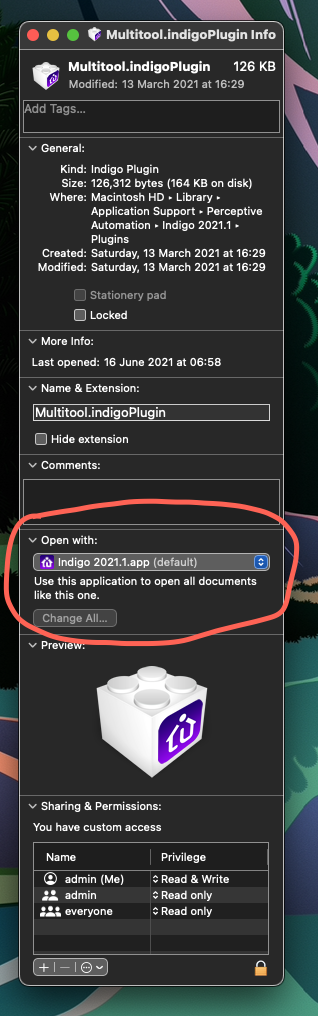

Actually, this is a better procedure and more likely to work:
  1. If you haven't got immediate access to a plugin file, navigate to the Indigo plugins folder at /Library/Application Support/Perceptive Automation/Indigo 2021.1/Plugins
  2. Right click on any plugin and click Get Info
  3. Under the Open with section, it should show Indigo 2021.1.app
  4. If it doesn't e.g. it shows Indigo 7.5.app then ...
  5. Click the pull down and select Indigo 2021.1.app from the list of files
  6. Click Change All... button
  7. Click Continue to confirm change
If you have a situation where the Indigo 7.5 Client has started, it might be best to stop the server, quit Indigo and restart it before doing the above procedure. :)

Hi Jon, I do not see the Change All button. It is showing Indigo 7.5.app as the default app to open with and Indigo 2021.1.app is in the list of apps to choose from.
However, when I select the always open with tick, fine, it launches v2021 Indigo OK, but then when I go back to my downloaded plugin update and double-click that, it launches v7.5 again.

You are right clicking on the plugin and selecting Get Info?

Hackencrash
Posts: 251
Joined: Wed Dec 16, 2015 7:05 am
Location: UK
Re: v7.136.528 compatibility with Indigo 2021.1?
Post by Hackencrash »
Perfect !!!
Thank you :D
