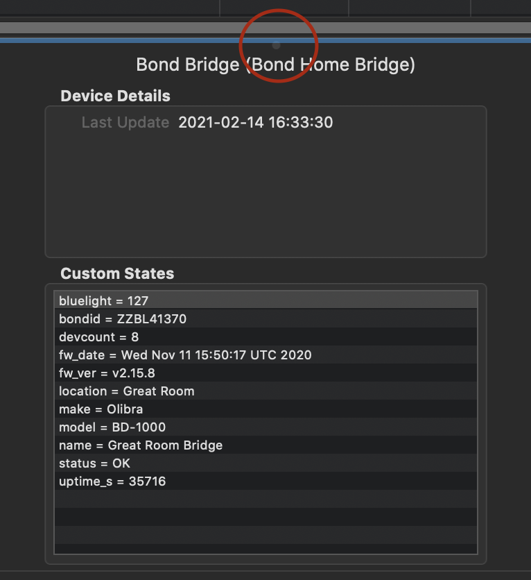

To get the states of the device that you can access, you need to expose the state list below the standard UI. To do that, drag UP on the dimple at the top of the device details pane:

As Joe has illustrated, all the custom state names are listed in custom states are in the Indigo devices UI.
