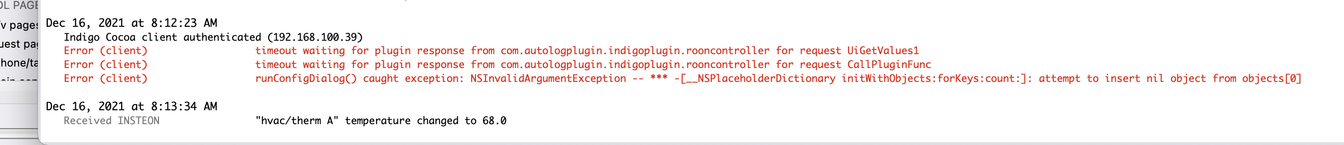

i assume it's a port change as others have noted. however, i cannot get the plugin config to load in order to try to change the port (not sure if that's even an option); getting this error when loading config:

Yes, I had just picked that up as well.
I will take a look at it in the next few days (or sooner). Not sure how difficult it will be to implement; it depends on the previously mentioned issue regarding Python 2.7 and Python 3.
I will look at the config problem which I have also seen. The port number isn't configurable as it is hard coded to 9100 in the code. I changed it in the code in order to test the other ports.
Obviously, I am keen to get this issue sorted. I will keep you posted. Please bear with me.

Re: Roon 1.8 [WORKAROUND FOR ROON BUILD 880]
I have started looking at how to enable discovery today. In the process, I have discovered that the base port is now 9300. I changed the fixed value in the plugin and I have now got it working again.
