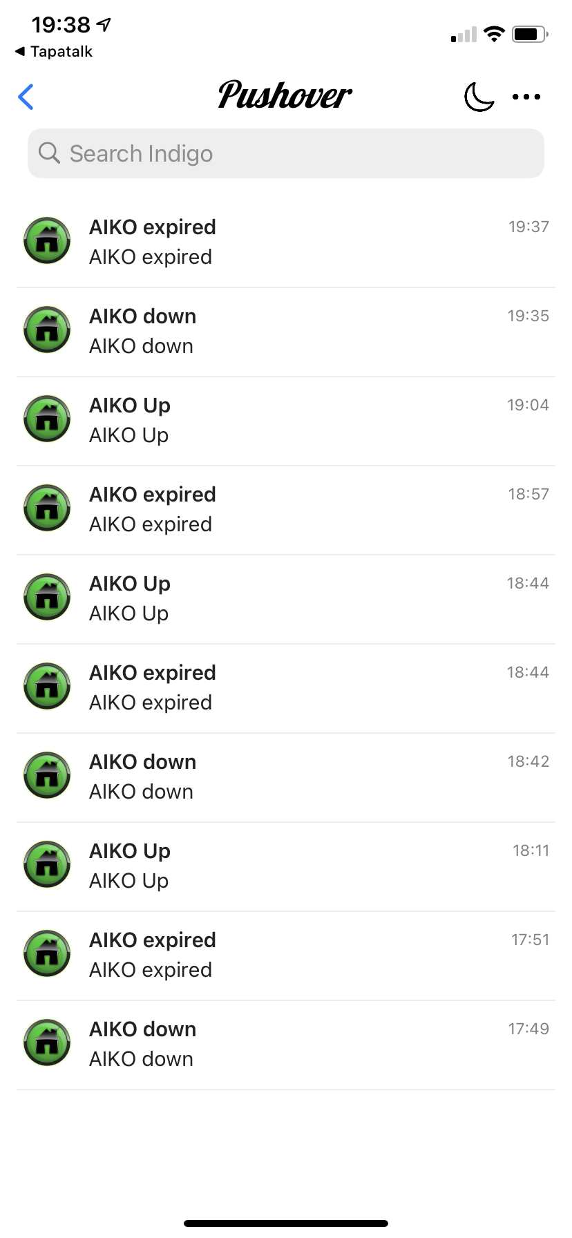

Press button on AIKO, it wakes up and my new saved device "My AIKO Tag" status changes to "up". <-- good
30 minutes later +/-, AIKO status changes from "up" to "down", followed by "expired".
AIKO stays "expired" until I press the button on the AIKO again.
I'm hypothesizing that there is a power saver option somewhere, but unfortunately I think it is an app controlled option and the app is no longer in the apple App Store. :(
anyone have tips or pointers on how to keep this thing alive?

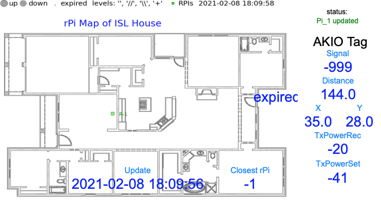

Before Pushing the button
Screen Shot 2021-02-08 at 6.10.21 PM.png (98.69 KiB) Viewed 4986 times

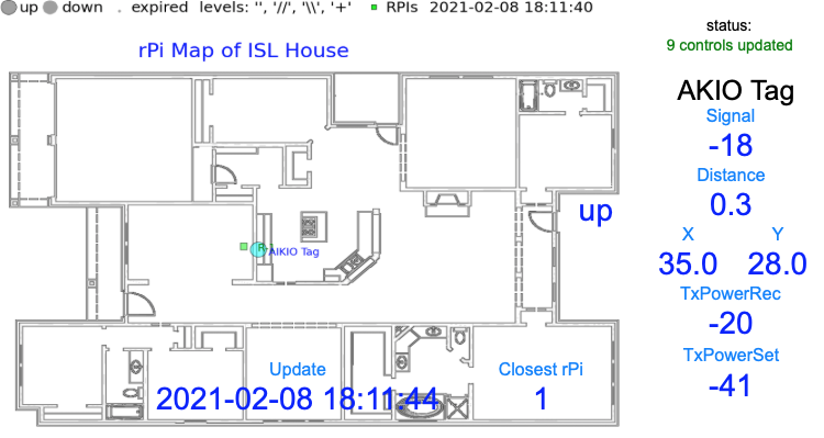

After Pushing the button
Screen Shot 2021-02-08 at 6.11.45 PM.png (98.31 KiB) Viewed 4986 times

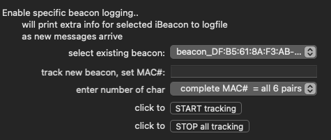

Can you do menu / track specific beacon
And select the Aiko.
Then check plugin.log

kw123 wrote:Can you do menu / track specific beacon
In Indigo Log, Returns:
iBeacon Error                  Error in plugin execution GetUiDynamicList:
TypeError: UI dynamic list function must return a list of id/name pairs, or a list of strings
   piBeacon Error                  Line 11664 has error=Unterminated string starting at: line 1 column 111 (char 110)
   piBeacon Error                  {"pi":"1","program":"beaconloop","ipAddress":"192.168.1.87","ts":{"tz":"CDT","time":1612838759.36},"trackMac":"45:46.1-START   24:DA:11:26:37:F2\n \nTRACKMAC started on pi#:1, for MAC# 24:DA:11:26:37:F2, options: raw:False, filter:><
And select the Aiko. - Dynamic list didn't populate it, manually entered the MAC address.
2021-02-08 20:45:44 sending command to rPi at 192.168.1.87; port: 9999; cmd:trackMac
2021-02-08 20:45:59.478	ERROR       	Plugin.variableUpdated           Line 11664 has error=Unterminated string starting at: line 1 column 111 (char 110)
2021-02-08 20:45:59.478	ERROR       	Plugin.variableUpdated           {"pi":"1","program":"beaconloop","ipAddress":"192.168.1.87","ts":{"tz":"CDT","time":1612838759.36},"trackMac":"45:46.1-START   24:DA:11:26:37:F2\n \nTRACKMAC started on pi#:1, for MAC# 24:DA:11:26:37:F2, options: raw:False, filter:><
...and in device edit set accept all packages to on . Is that the beacon message types? I have that set to "ALL message types".

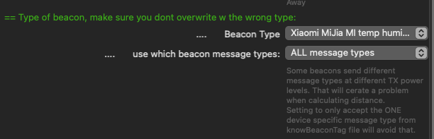

3. and in beacon device edit set accept all packages:
Screen Shot 2021-02-08 at 22.29.12.png (30 KiB) Viewed 4884 times

3. accept all packages in beacon
then the aiko should work fine.
