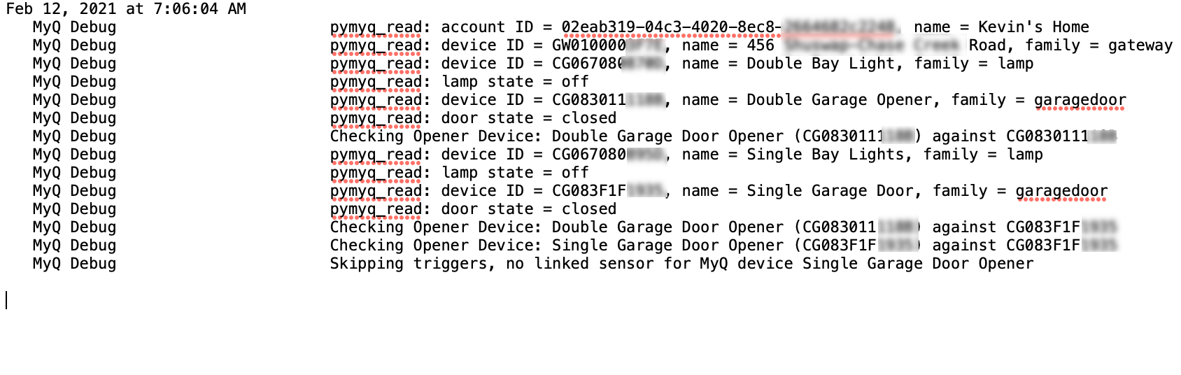

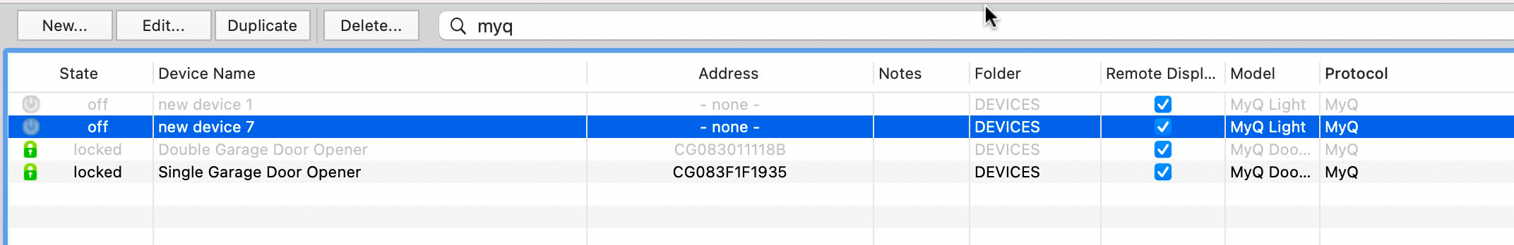

The plug in installed and my 2 lights auto populated ...
The api seems to be giving all the devices to the plugin (looking at the log)..

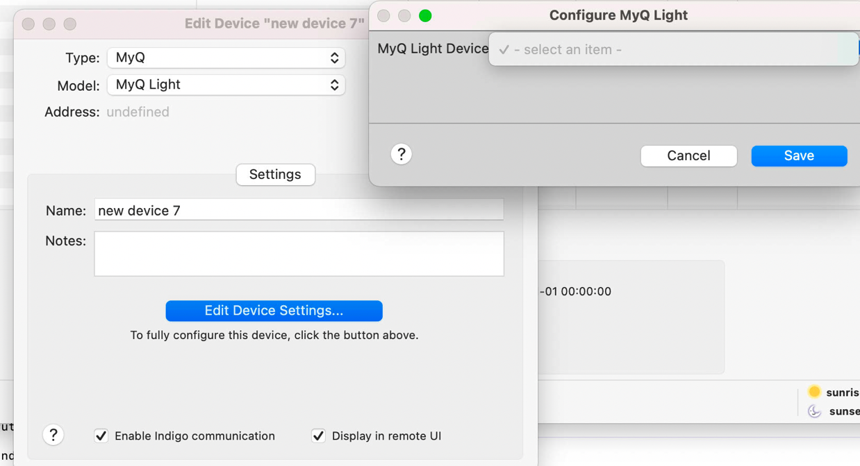

The new devices are identified correctly as MyQ lights, but there are no MyQ light Devices available in Edit Devices --> EditDevice Settings...--> Configure MyQ Light --> dropdown .
Hope this report helps...

Can you please enter this as an issue in GitHub?
https://github.com/FlyingDiver/Indigo-MyQ/issues
And do an actual copy and paste from the logs, not a screen shot.
