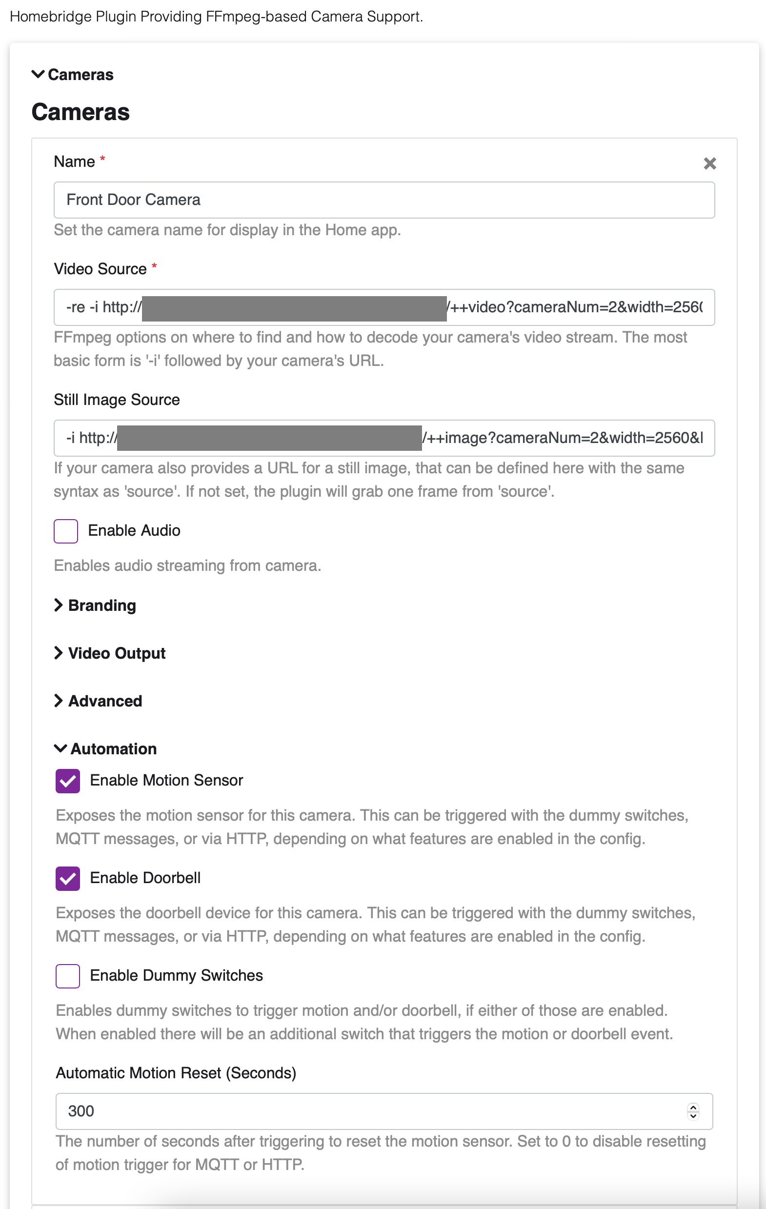

In Homebridge configuration for Homebridge Camera FFmpeg:
Camera video source as (replace LOGIN, PASSWORD, HOSTNAME, PORT, and CAMERA as configured in SecuritySpy - update width and height to match your camera's resolution):
Still image source as (replace LOGIN, PASSWORD, HOSTNAME, PORT, and CAMERA as configured in SecuritySpy - update width and height to match your camera's resolution):
Check Enable Motion Sensor and/or Enable Doorbell under Automation.

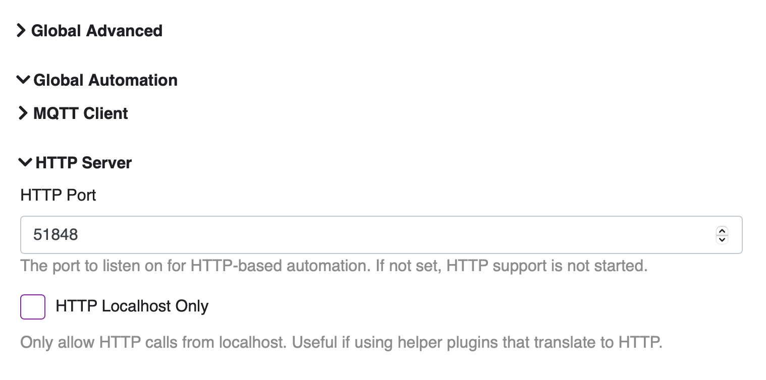

Under Global Automation, choose any unused HTTP Port under HTTP Server.
-re -i http://LOGIN:PASSWORD@HOSTNAME:PORT/++video?cameraNum=CAMERA&width=2560&height=1440 Code: Select all
-i http://LOGIN:PASSWORD@HOSTNAME:PORT/++image?cameraNum=CAMERA&width=2560&height=1440 Under Global Automation, choose any unused HTTP Port under HTTP Server.

- Screen Shot 2021-01-31 at 4.11.31 PM.png (380.67 KiB) Viewed 3675 times
- Screen Shot 2021-01-31 at 4.12.22 PM.png (91.12 KiB) Viewed 3675 times
