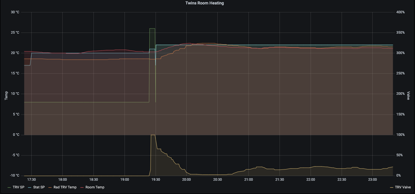

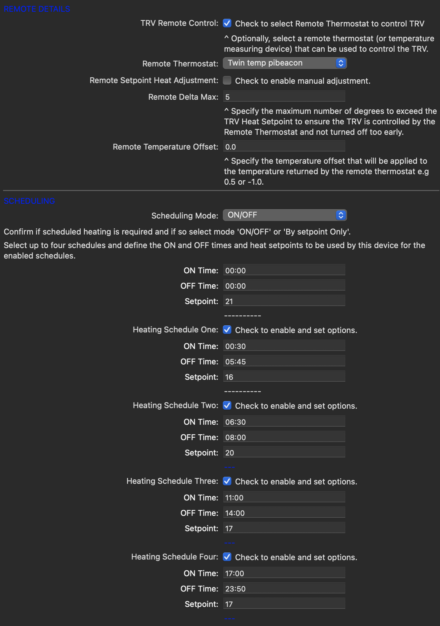

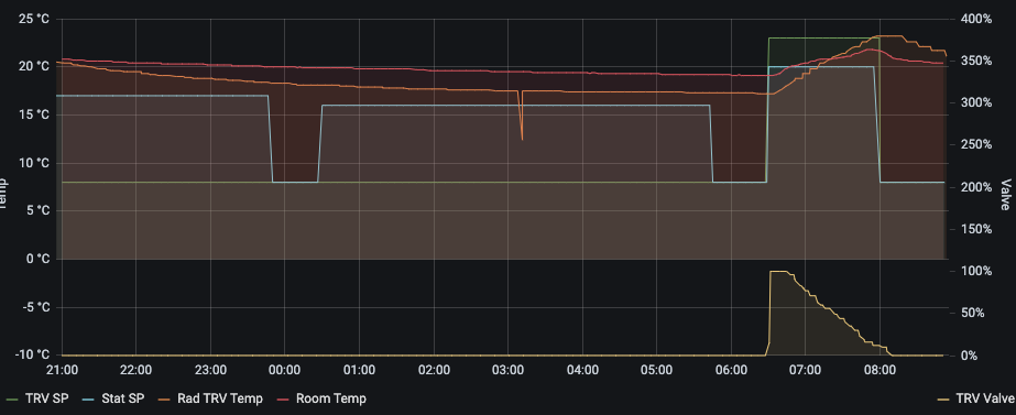

Hi Jon, Might be missing something there, but these 2 rooms seem to be behaving differently
At approx 15:00 the temp sensor goes above the Stat SP and the TRV SP is set to 8 c from its overriden value 3 degrees above the Stat SP and the valve goes off.
However on this one
The plug in doesnt seem to adjust the TRV SP to 8 and so it continues to manage the temperature to the overriden TRV SP using the valve % so the room maintains at a higher temperature than the desired set point.
Both use remote temperature sensors and appear to have the same settings.
Any ideas?
Simon

Re: Inconsistent behaviour
Hi Simon.
Happy New Year to you.
Looking at the second image, both the Remote and TRV set-points seem to be going to 8C between 14:00 and 17:00?
So unless I am missing something, it looks OK?

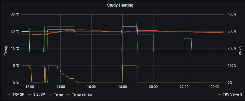

Happy new year to you too.
It’s at 18:00 where I’d expect the TRV set point to go to 8 as the room temp was higher than the desired set point
I agree, it doesn't seem correct.
Are you sure that the Remote Stat is being used to monitor the temperature? I know you probably are, but just double checking.
Because, if it was using the TRV temperature to monitor the temp, it would be correct.

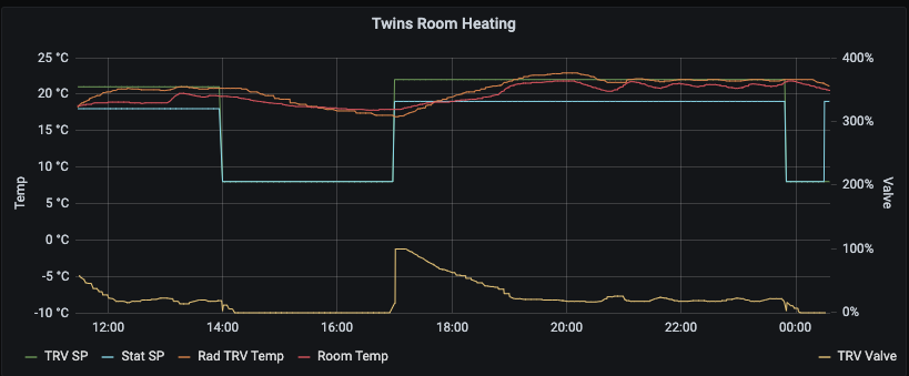

Hi Jon. Its that time of year again and realised that this strange behaviour is still happening on the twins' thermostat.
Its not setting the setpoint on the TRV to 8 once the remote temperature reaches the plugin setpoint of 20.
Any ideas what might be going wrong?

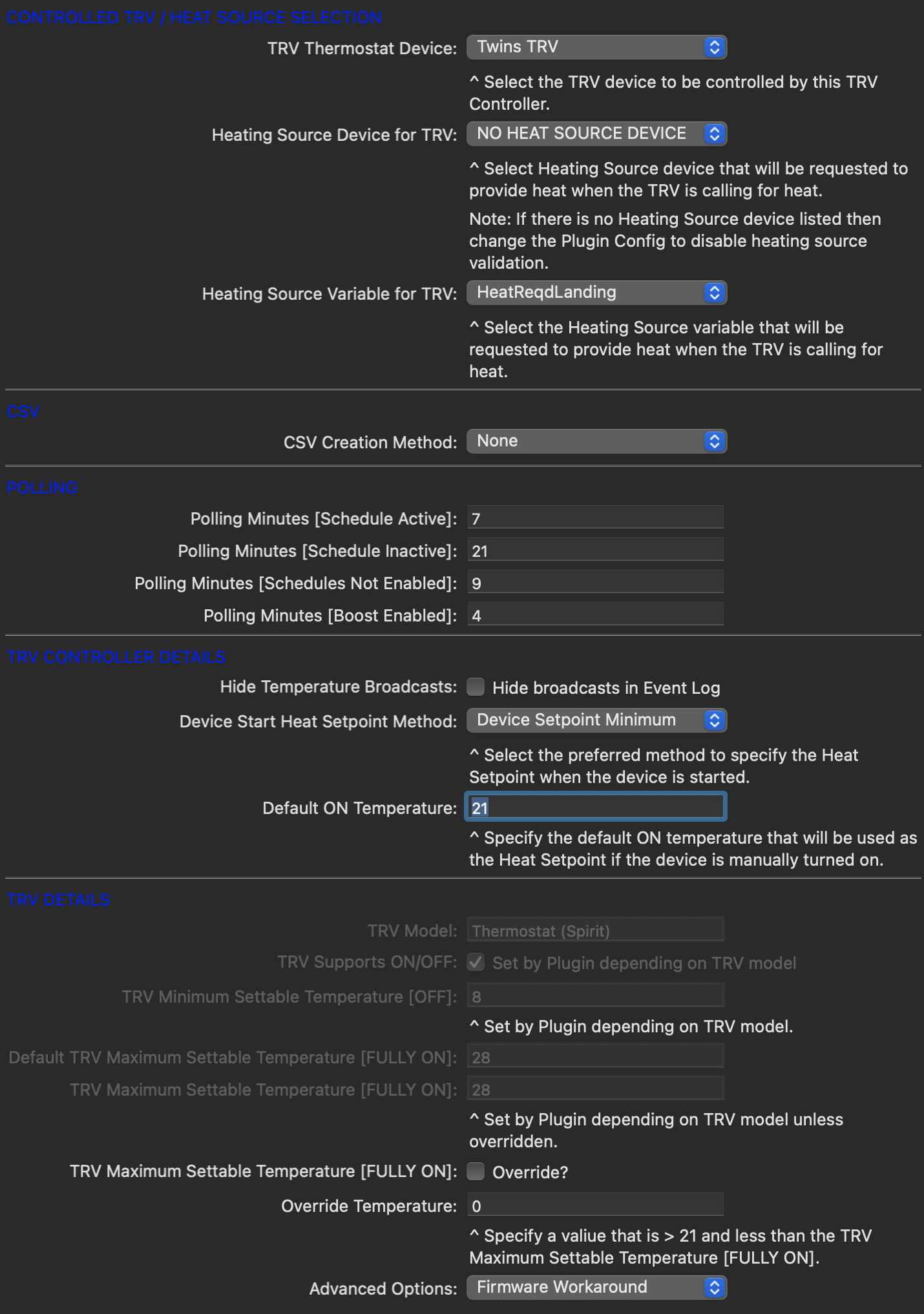

Interestingly I was getting this behaviour on another room and created a new TRV controller device with what I thought were same settings, moved all the dependencies over and deleted the original device.
The behaviour is now as expected, ie the TRV setpoint goes to 8 when the remote temperature sensor is higher than the controller setpoint.
Is it possible that the old device has not properly captured the remote sensor despite it showing in the GUI?

Hi Simon,
I agree it looks odd.
Is there anything special about the Twin Temp piBeacon and is that the same stat in other room that is working OK?
You could try the procedure you use in the other room to correct it on the twins' room, to see if that resolves it.
Other than that, I would probably need to see some debugging logs for the time period it happens in order to see if that throws any light on the issue?
Yes I’ve recreated a trv controller device. Copied settings from the screenshots on here and deleted the old one. Initial impressions are that it now work as expected whereas the old one didn’t.

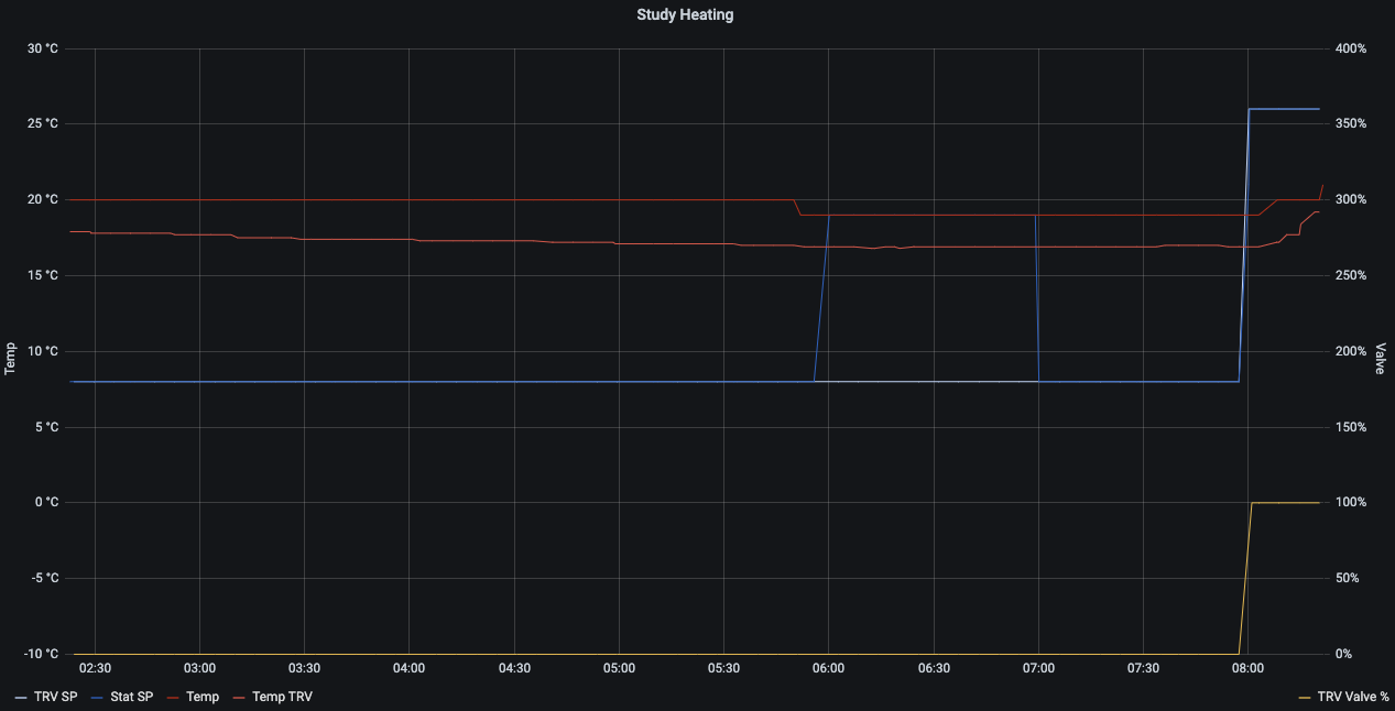

I set the trv controller to 21 at 19:20 and it did some weird behaviour. The TRV isnt 5 degrees higher and the the TRV is not set to 8 when the remote temp exceeds the set point.

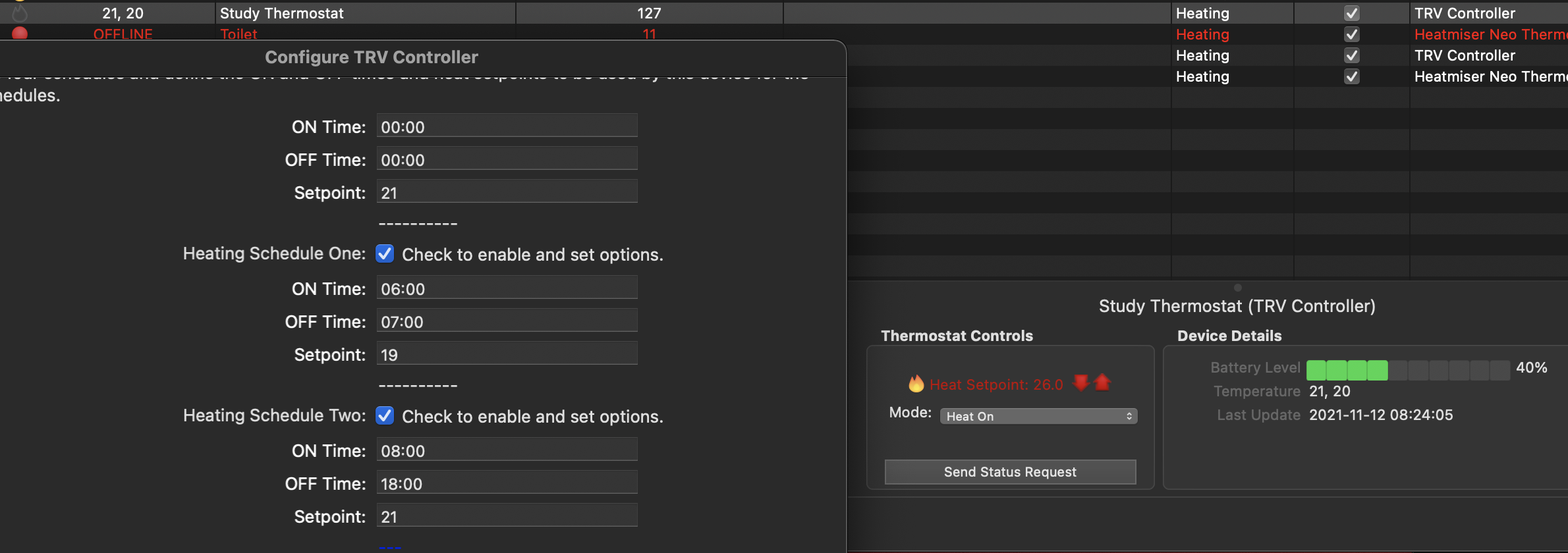

Morning Jon,
This is strange.. schedule set to set study to 21 with a 5 degree offset. Except the setpoint on the trv controller as well as the trv itself are both set to 26.
edit: when I reloaded the TRV plugin, the controller SP was reverted to 21 as it should be and the valve then went to off.
This seems to be the relevant bit of code. The setpointHeat was at 21 and setPointTRV at 26 for a second or 2, then the TRV seems to go to TRV hardware control and the setpointHeat goes to 26. There is a weird line with the setpoint at 119.8 at 08:00:17.348

- Screenshot 2021-11-12 at 08.22.10.png (57.43 KiB) Viewed 4141 times
- Screenshot 2021-11-12 at 08.24.29.png (369.33 KiB) Viewed 4141 times
I have now started plotting the controllerMode in grafana and 2 of the TRV controllers are in mode 3, ie TRV Hardware Control, even though they havent been touched and have child lock on.
Restarting the plugin resets them to mode 0 Auto, but then they flip back to mode 3. Is this expected behaviour?
