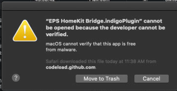

Interesting that during startup when I RDP to the server I get this exception:
Screen Shot 2020-12-29 at 2.40.49 PM.png (42.55 KiB) Viewed 1706 times

An interesting point is that connection via a Remote Indigo UI didn't generate the above error (not that I'd expect that). I didn't see it unless I VNC to the server itself.
After enabling and applying the exclusion in the security preferences pane, I was able to cleanly start the plugin without issue.
