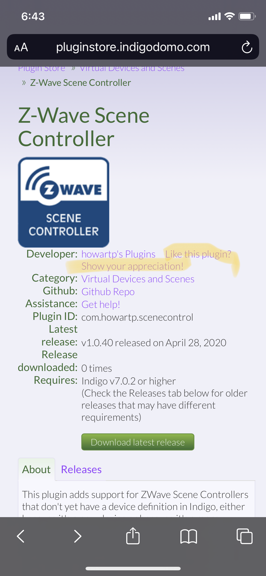

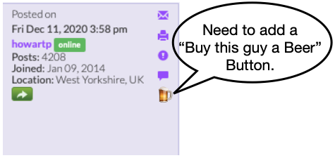

jay (support) wrote:Was hoping you might... :D
Screen Shot 2020-12-11 at 4.21.59 PM.png (40.55 KiB) Viewed 5468 times
Bill
My Plugin: My People
jay (support)
Posts: 19232
Re: Feature Request: ZWave Watcher Triggers/Actions
Post by jay (support) »
Screenshot 2020-12-11 at 6.43.55 PM.png (672.08 KiB) Viewed 5435 times
Jay (Indigo Support)
Twitter | Facebook | LinkedIn
whmoorejr
Posts: 844
Location: Houston, TX
Post by whmoorejr »
Wow. I can't believe I never noticed that before. Thank you Jay for pointing that out and thank you Peter for always helping me out whenever I've asked.... even though I haven't shown any monetary appreciation... yet.
Bill
