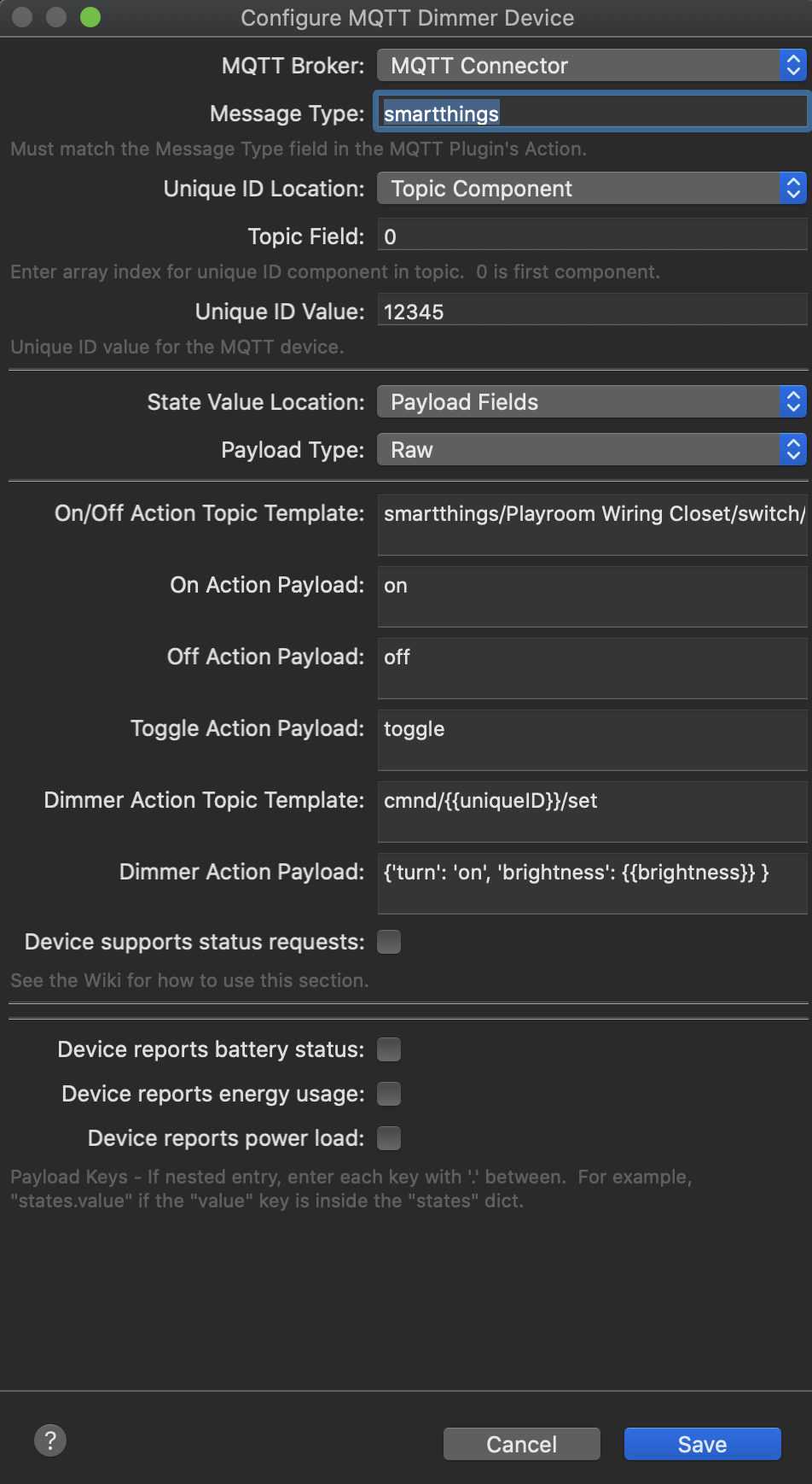

I've finally worked out how to use this plugin to pass MQTT messages to SmartThings (ST). This has allowed me to integrate my Brilliant.Tech keypads into my Indigo setup. The remaining issue I have though is that I can't get Indigo to display the proper state in the UI (for now just on or off). This is just usually shows as the light bulb icon being on or off. When I toggle the MQTT Dimmer Device in question on or off, the appropriate status message fires, but the device state doesn't change. I have things configured as follows:
Screen Shot 2020-11-17 at 11.07.14 PM.png (303.42 KiB) Viewed 1638 times
I have to believe this is due to me not quite understanding the State Value Location Setting.

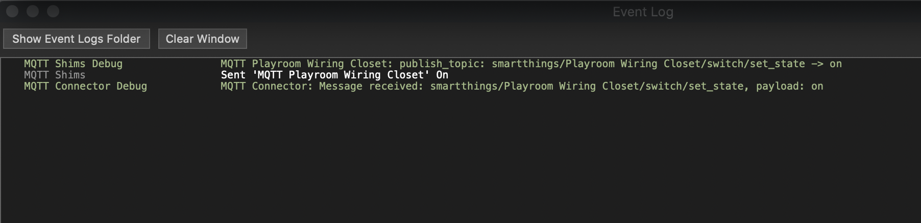

Indigo is properly seeing the MQTT messages and connecting it with the proper device:
Do I somehow have to trigger another MQTT to properly reflect the state somehow? It seems just a message to the topic smartthings/VDS/switch/state with value 'on' should do the trick?

So these are the state change messages from the device? The ones in the screen grab are the commands you're sending TO the device (which you're also receiving back from the broker).
smartthings/VDS/switch/state on
smartthings/VDS/switch/state off
Which is the "unique ID" associated with that specific device? 'VDS' or 'switch'? You must have the ST device configured so that a component of the topic (or part of a JSON payload) is a unique string which is specific to that device. Could be a name or serial number or hardware ID or similar.

You need to make sure that the status message from the device, and the commands to the device, use different topics and don't match the same triggers. Specifically, commands to the device (which will generally be echoed back by the broker) must NOT match the trigger used to update the Indigo device (ie, the status message from the remote device).
koensayr wrote: In this case "VDS" is the unique identifier that uniquely identifies the device to ST. VDS matches the name of the device in ST.
So your trigger needs to look something like:
Match: smartthings
Any:
Match: switch
Match: state
End:
Then in the Shim device, Topic Field is "1" (zero based list, second component) and the Unique ID field is "VDS".
