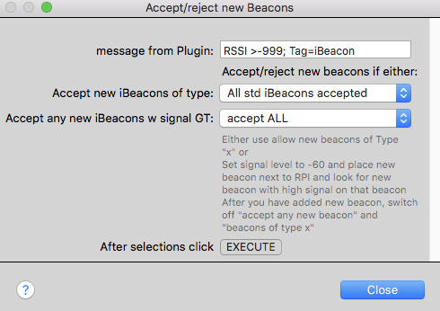

Re: Ruuvi Tags
All Std Beacons Accepted
accept ALL (=signal)
also, only reboot time variable seems to update...
// Jari
// Jari
- Screen Shot 2020-11-01 at 15.48.28.png (86.42 KiB) Viewed 4721 times
Re: Ruuvi Tags
It is either or not or
You have set to accept only std ibeacons
That is a certain format of the payload
the ruuvitags do not send ibeacons packages
They send temp hum pressure acceleration and count as payload and that package is changing at every package
[edit] actually i am wrong, there is a bug..
