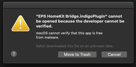

Hi, I just updated my Indigo machine's OS to Catalina and I'm getting an error with HomeKit.
Does anyone have any ideas what I can do???????

Right click on the plugin file and select "Open". Then confirm at the dialog.

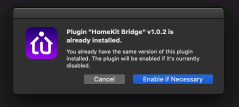

Re: Issue after upgrading to Catalina
When I do that I get an Indigo that says this plug-in is already enabled (see below) - Then I click "enable if necessary" but it just comes back with the same error?

HelpOct 12, 2020 at 2:52:32 PM
Indigo Cocoa client connected
v1.0.2 of plugin HomeKit Bridge is already installed and enabled
Reloading plugin "HomeKit Bridge 1.0.2"
Stopping plugin "HomeKit Bridge 1.0.2" (pid 4623)
Stopped plugin "HomeKit Bridge 1.0.2"
Starting plugin "HomeKit Bridge 1.0.2" (pid 8930)
HomeKit Bridge Caching all HomeKit Bridge devices...
Started plugin "HomeKit Bridge 1.0.2"
HomeKit Bridge Attempting to start 'Homekit Server'
HomeKit Bridge HomeKit Bridge is running the latest version, no update needed

In Terminal, enter:
Put the path to the plugin at the end of the command.
sudo xattr -r -d com.apple.quarantine <path to plugin>

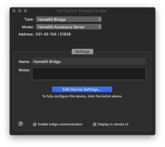

-To find it, edit your "HomeKit Bridge" (whatever you named it) device from the main Indigo devices window.
-Click the Edit Device Settings... button which brings up the Configure HomeKit Accessory Server window.

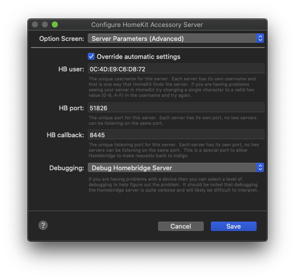

-Change the Option Screen dropdown to "Server Parameters (Advanced)"
-Check the "Override automatic settings" checkbox
-You should now see the HB user, HB port, and HB callback fields. (For me HB user was blank)
-Paste your MAC address in the HB user field and make sure it's all uppercase.
-Save that.
-Try turning on the HomeKit Bridge device. Reload the plugin if you need to.
Hopefully that helps, it worked for me.
-Save that.

Thanks - mine had a MAC listed but it was not for my current Indigo machine - I updated it and that cleared the error dialog. Then I had to delegate the server from apple home and rebuild everything. Thanks for getting me going on this - I use HomeKit with some actions to set home and away status for myself (since I take my phone when I leave home).

4) In the "Configure Homekit Accessory Server" dialog that results, select "Server Parameters (Advanced)" from the first, "Option Screen" dropdown menu.
5) Change the MAC address in the "HB User" field to match the MAC address of the computer that the Indigo Server is running on, all UPPER case.
6) Click the Save button
