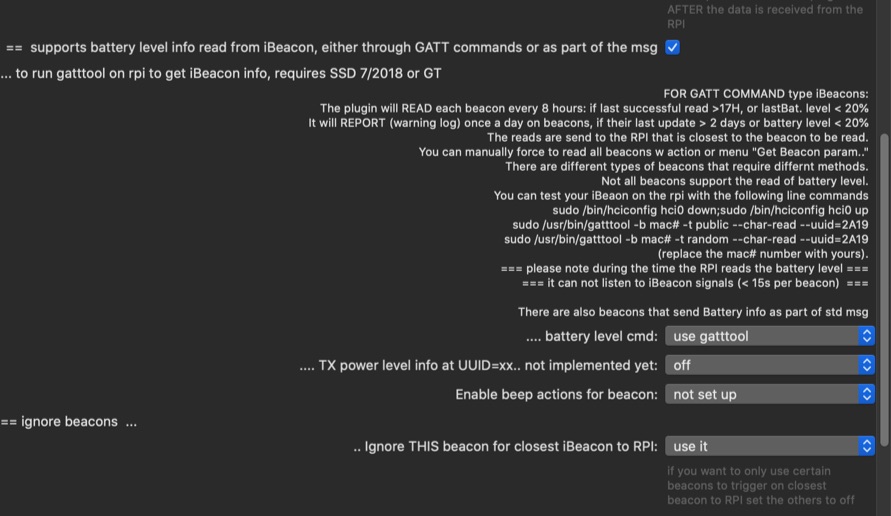

I have a few Nonda iHere beacons and unsure why the battery level is not showing. They are the iHere which apparently work to get battery level and I enabled it in the beacon edit. Do I need to install gatttool or update the SSD image? I am on the latest plug-in. Beacons work fine but don't show a battery level (technically it shows the meter but it's at zero.
How to get Battery Level to work
- Configure_beacon.jpg (94.05 KiB) Viewed 3655 times

you can set beep to on.
looks good.
could you do
ssh to rpi
tail -f /var/log/pibeacon
then in plugin menu get ibeacon battery level..
and if you have > 1 rpi select the rpi you just ssh'ed and select all beacons < execute>
post the plugin.log part
there seems to be a problem w the RPI0w and the battery command, still on my to do list
so which type of RPI are you using?

Re: How to get Battery Level to work
Thanks. Unsure I have a use case fro the beep (and I don't have a current ssd image.....mine is likely from 2017.
You said "then in plugin menu get ibeacon battery level.."
I don't see a menu item labelled 'get ibeacon battery level". Do you mean "Get iBeacon Parameters from rPi"? If so, here's the output of the log:
let me know if I can provide any other details to help get battery levels reporting.
ok, I think it doesn't work for me as I have an old SSD card image. So I assume I just need to shutdown the rPis, put the new image on SSD and insert the SSD into the rPi and power up the rPi?
Also, not sure if it is just me but twice now since updating to the latest plug-in, my rPis seem to keep going up and down repeatedly. Stopping/Restarting the plug-in has no affect, but restarting the Indigo server fixes the issue at least for a few days to a week. Just throwing this out there should anyone else be experiencing the issue.
>> ok, I think it doesn't work for me as I have an old SSD card image. So I assume I just need to shutdown the rPis, put the new image on SSD and insert the SSD into the rPi and power up the rPi?<<
in principle yes, You might have an issue with the ssh fingerprint signature file, but pibeacon SHOULD take care of that.
