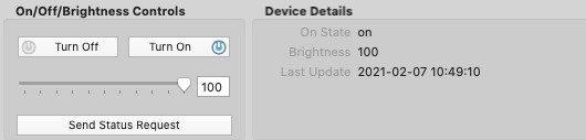

Lights:
Screen Shot 2021-02-07 at 9.52.26 PM.png (16.97 KiB) Viewed 3717 times

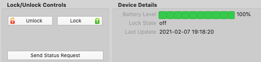

Screen Shot 2021-02-07 at 9.52.35 PM.png (16.03 KiB) Viewed 3717 times

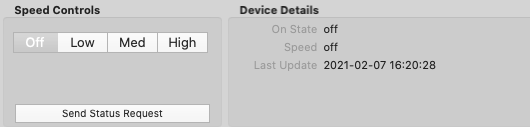

Fans:
Screen Shot 2021-02-07 at 9.52.47 PM.png (15.21 KiB) Viewed 3717 times
There are others... sprinklers, thermostats, and....

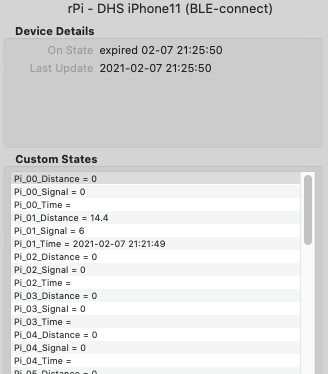

Custom devices:
Screen Shot 2021-02-07 at 9.53.50 PM.png (30.65 KiB) Viewed 3717 times
You may have to expand the bottom half of the main page, then just use the scroll bars to see all the state information.
You could also make a quick little control page with a single device showing the value of it's signal. Bring that page up on your phone, then walk around with the blue tooth thing and see what happens.
When you start playing with scripting stuff, you can scroll through the custom states of a device, right click to get the state key for use in a phython script or for use elsewhere.
