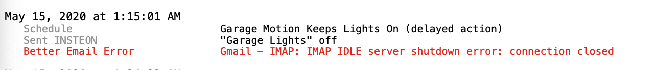

So recently, I've noticed that all of my messages in my gmail inbox are being deleted, which I am using as the e-mail server for better e-mail. They're gone, poof, nowhere to be found in any email folder, deleted or otherwise. I'm not entirely sure that it is better e-mail causing the issue other than gmail support says that a 3rd party client could be the cause of the issue and BE is the only 3rd party client I'm using. Furthermore, I've noticed that in my log there is an error related to better e-mail which further leads me to suspect BE as the cause of the issue. Any help would be appreciated!

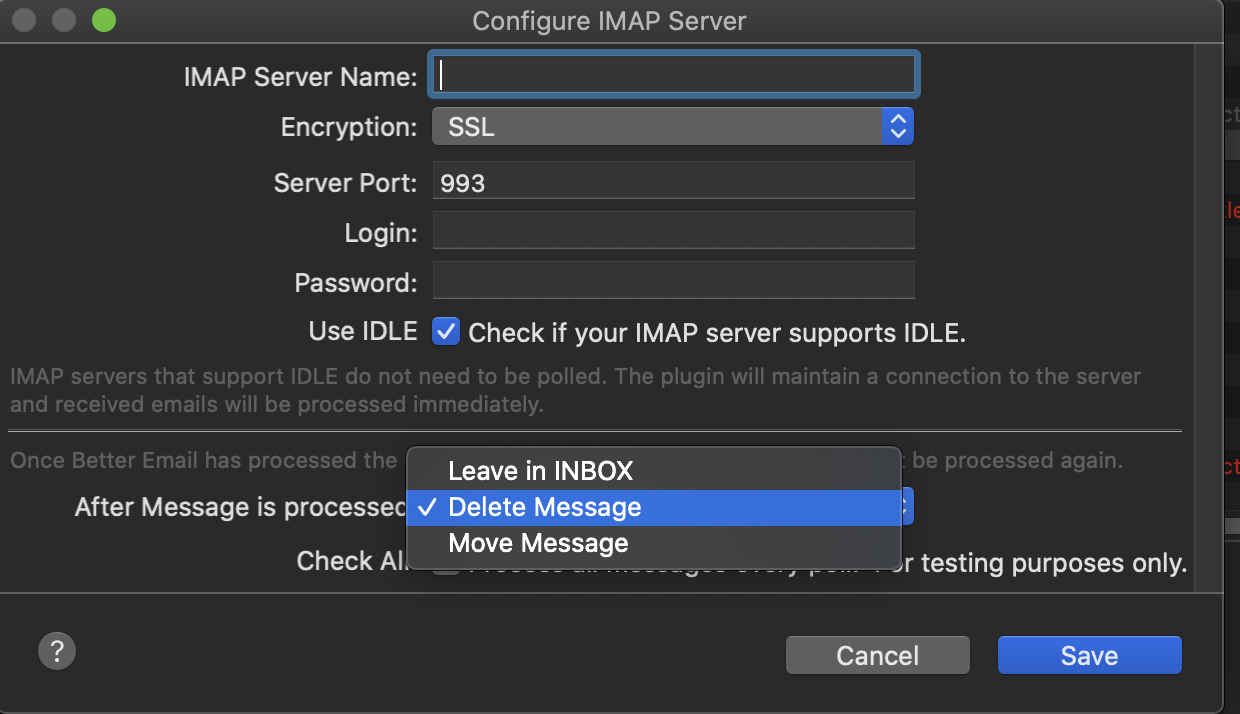

You really shouldn't be using the same email address for Indigo as you use for your regular email. The plugin is for email specifically for Indigo, not for"you".
In any case, what the plugin does with the email that it's scanned is set in the device configuration dialog, as below. What are your settings?

That error just means the connection was unexpectedly closed, not that there was an error processing the messages. If that's happening a lot, turn off IDLE processing and set an appropriate poll interval. I don't think Gmail does IDLE properly. In fact, I really recommend NOT using Gmail for the plugin as it's IMAP support is buggy.guitarfreak wrote:Furthermore, I've noticed that in my log there is an error related to better e-mail which further leads me to suspect BE as the cause of the issue. Any help would be appreciated!

thank you for the help, it's not my primary e-mail address that I'm using, but a secondary G-mail one. I exhausted all of my other imap e-mails after not being able to get them to work so finally settled on gmail... which is working fine, other than this specific issue and the connection issue I mentioned.
It does appear it was set to delete all messages after processed so I've changed that setting which hopefully fixes the issue.
