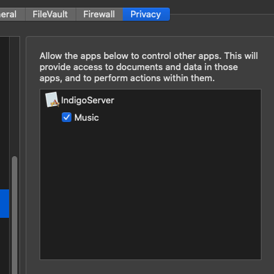

If somebody wants to give it a shot... I think you could modify the actions.xml and change the iTunes by Music. Something like this:
<Action id='launch'>
<Name>Music Launch</Name>
<CallbackMethod>launch</CallbackMethod>
</Action>
as opposed to:
<Name>iTunes Launch</Name>
</Action>
But this is a guessing... I have never ever done apple scripting in any kind or form but I tasted the below script that was originally for iTunes and changed iTunes by Music and it worked...
tell application "Music"
set sound volume to 40
set EQ enabled to true
play
end tell
Changing the xml after the plugin has been installed is fairly easy I think... If anyone more versed on this than me (very easy) could confirm is this makes sense...
Anyway.. perhaps if anyone wanna give it a try as far fetched as it sounds... just copy and paste the following, then save it to a file called Actions.xml perhaps restart something and give it a try? I just copied the Actions.xml from the GitHub site and changed every iTunes for Music...

I can't get the plugin - 0.0.8, to work.
I've tried the trick Mat suggested (authorized Indigo to control Music, restarted the Indigo server), but it doesn't work.
Still get these errors:
Any ideas?
iTunes Local Control Error Error in plugin execution InitializeMain:
File "plugin.py", line 12, in <module>
File "/Library/Application Support/Perceptive Automation/Indigo 7.5/Plugins/iTunes Local Control.indigoPlugin/Contents/Server Plugin/iTunesAppleScript.py", line 96, in <module>
File "/Library/Application Support/Perceptive Automation/Indigo 7.5/Plugins/iTunes Local Control.indigoPlugin/Contents/Server Plugin/iTunesAppleScript.py", line 23, in _make
File "/Library/Application Support/Perceptive Automation/Indigo 7.5/IndigoPluginHost.app/Contents/Resources/PlugIns/applescript/__init__.py", line 49, in __init__
ScriptError: Expected end of line, etc. but found identifier. (-2741) range=78-83
