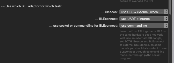

do you have an RPI3?
you can check w " tail - 500 /var/log/syslog" if you see a lot of bluetooth errors:
then you need to move the iBeacon bluetooth to an external dongle and use the internal for BLEconnect w command line option
in RPI device edit:

Re: PIs stop sending beacon data in 118.338
@ johnpolasek
v7.118.339 should fix that problem
