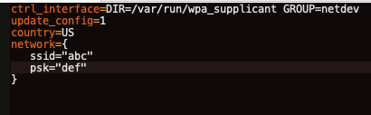

2.create a file like this one:
Screen Shot 2020-02-26 at 14.27.21.png (12.85 KiB) Viewed 7178 times
replace abc def with your SSID and password. Keep the " in the text
ctrl_interface=DIR=/var/run/wpa_supplicant GROUP=netdev
update_config=1
country=US
network={
   ssid="abc"
   psk="def"
(this is the bare minimum supplicant file)

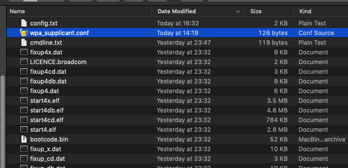

3. save as wpa_supplicant.conf onto the drive:
Screen Shot 2020-02-26 at 14.27.01.png (81.56 KiB) Viewed 7178 times
You can edit it anywhere save and copy from there, or create it directly on the SSD
Make sure you don't use textedit. That will create curly " (rich text format) then it will not work.
4. unmount drive
5. put SSD into your Pi0W, power up. It should start and copy the wpa_supplicant.conf from the boot drive to the proper location and restart.
Then it should automatically connect to your WiFi - if you have done everything correctly.
