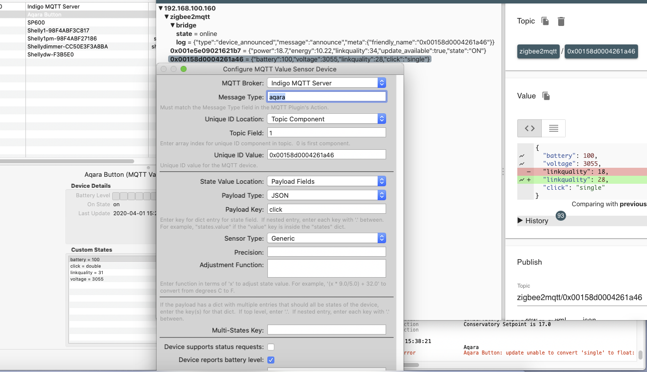

I have just recieved one of these but mine has click = single , double, hold and release !!!
How have you setup the shims as I keep getting
   Trigger                         Aqara
   MQTT Shims Error                Aqara Button: update unable to convert 'single' to float: could not convert string to float: single

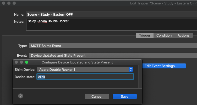

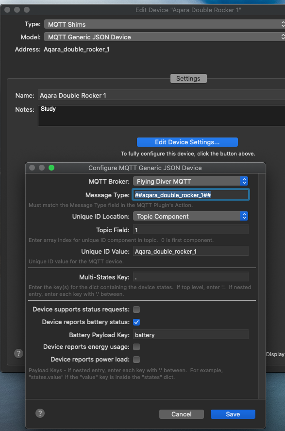

I set my Aqara Double Switch up as a generic JSON Device and then use different triggers to pick the different payload states. :)

Trigger to process click:

The MQTT Shims device definition:

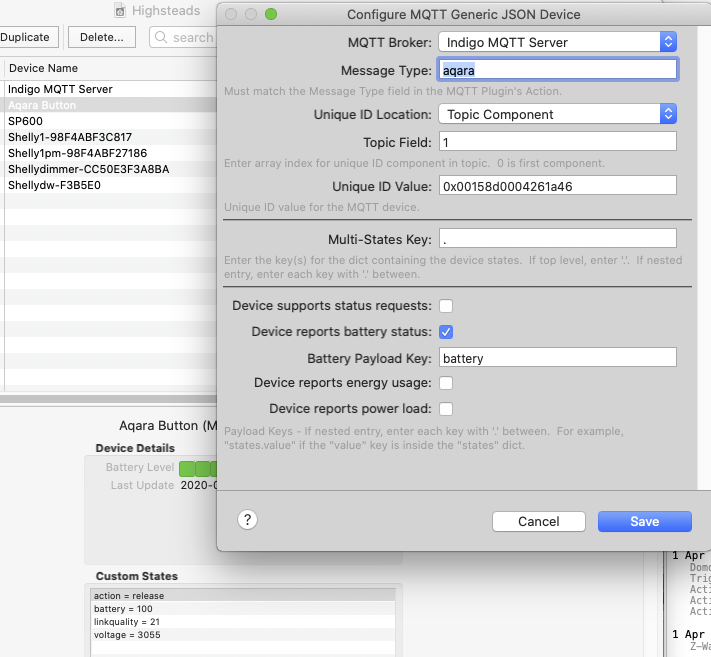

Thanks Jon, now have it sorted with the following for anyone else who gets one, It now shows click=single, click=double but when I hold the button it removes the click= and adds action=hold and action=release.
Just need to sort out my Aqara 2 gang wireless switch which your post should help with and also a 4 key Aqara Opple.
Screenshot 2020-04-01 at 17.55.50.png (165.33 KiB) Viewed 2965 times
And yes that . in the Multi-States Key is needed!!
