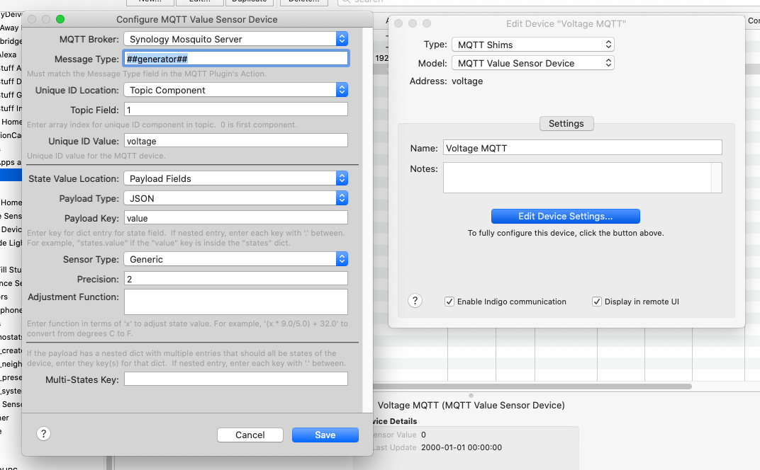

I am trying to get MQTT to work with my Generator, however I am not getting any values for the Shim...

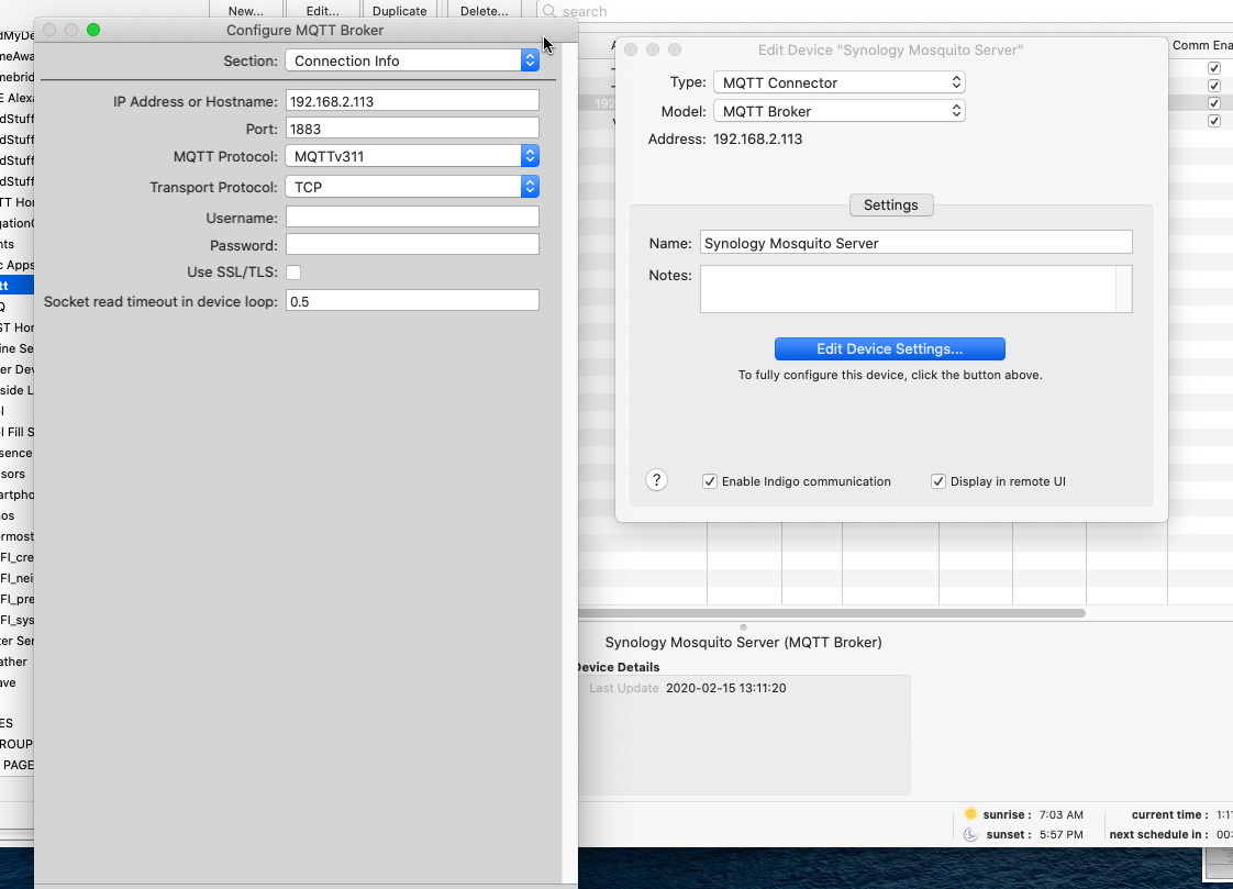

I have a MQTT Server set up on my Synology NAS. It is set to communicate with my Generator's MQTT. I know that it is publishing topics because I can see values using MQTTlens (Figure 6). I have set up the MQTT Connector to connect to the MQTT Server (Figure 5). I have the topic subscriptions listed (Figure 4). No other additional setup done under MQTT Connector.
SHOULD I DO . MORE FOR THE MQTT BROKER SETUP???
now for setting up Shim...

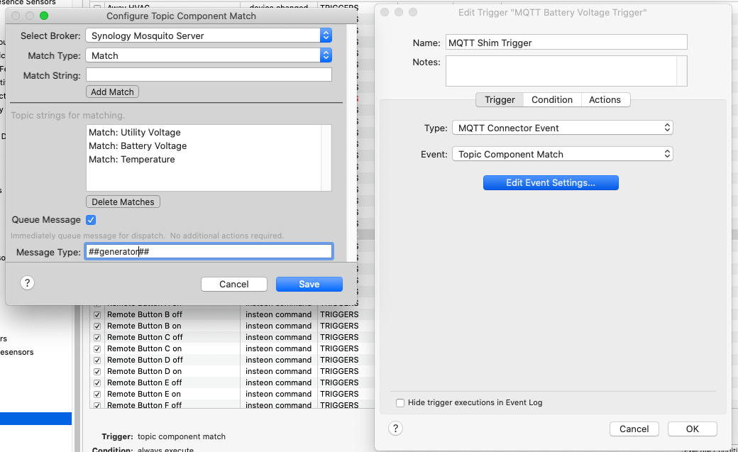

First set up trigger...
I choose my Broker - Synology, selected Match and entered three Strings.. Utility voltage, Battery Voltage and Temperature with message type ##generator## (Figure 3). I entered always and left the action as No action.... IS THIS CORRECT or do I need to do a specific action???
Now created a MQTT Shim...
I created a shim as a value sensor with message type ##generator## Topic Component 1 with ID value of voltage. I choose PAYLOAD Fields, JSON . (Figure 2)
BUT I AM NOT SURE WHAT THE PAYLOAD KETY SHOULD BE???? - I choose value and left the sensor type as Generic.

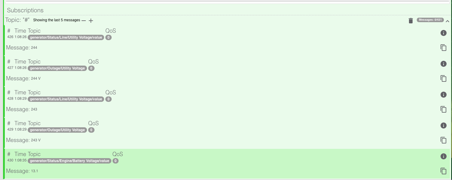

I do not get a value listed .. (Figure 1). I also did it similarly for ambient temperature also without success..
Any and all help would be appreciated.

Ok, there's a number of issues with your setup. Did you follow the wiki article? https://github.com/FlyingDiver/Indigo-S ... asic-Setup

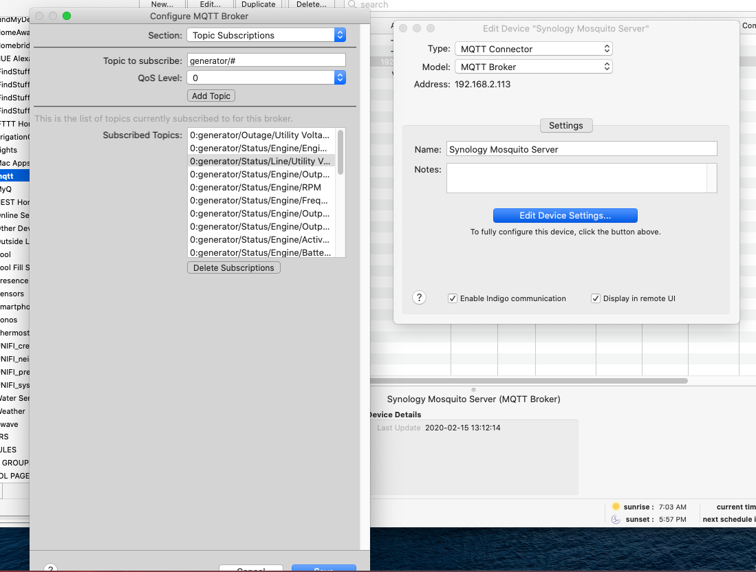

First, you probably just want to subscribe to "generator/#". '#' is the MQTT wildcard. Doing it with specific topics is error-prone.
Second, your trigger setup is all wrong. You don't set up matches for ANY topic you're interested in, you set it up for a SPECIFIC topic. And you do that by listing each topic component, in order that they appear. So I think you want:
Since you checked the "queue message" box, no explicit actions are required.
Third, you have the "Payload Type" wrong. Looking at the MQTTLens screen shot, the topic "generator/Status/Line/Utility Voltage/value" is a simple "244". Which is not JSON, so you want that field to be "Raw". Which doesn't have a payload key.
I don't have a Voltage type, so Generic is fine. Might as well set the Precision to 0, since the data doesn't have any decimals.
I think that's all.
Match: generator
Match: Status
Match: Line
Match: Utility Voltage
Match: value
End:

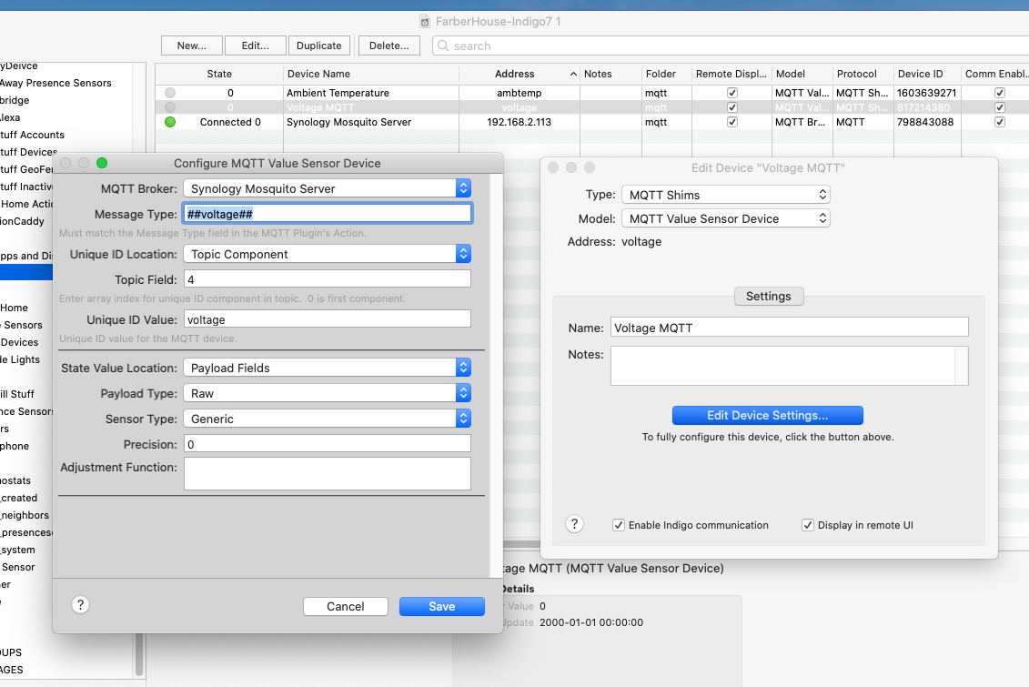

ok Fixed those things..
1. Changed Subscribe to # only and deleted all others
2. Changed trigger to have all parts of topic string - generator, Status, Line. Utility Voltage, and value (Figure3). I also renamed Message type to ##voltage##
3. Adjusted Shim to be Topic Field 4.
I still have State as 0 and getting an error -
I include the debug log if that helps.
I am sure I have something set wrong in the Shim Setup now.

- Screen Shot 2020-02-15 at 3.00.26 PM.png (258.45 KiB) Viewed 2973 times

Your unique ID for this device is "generator". Change that to field 0 and put in "generator". There is no topic component with the term 'voltage'.farberm wrote:ok Fixed those things..

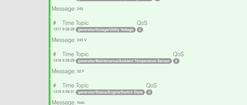

Flying Diver (sorry to bother you again):
I have all the numeric payloads working and have that figured out. I am still having problems understanding the JSON based payloads.
I re-read the Wiki...and I am trying to get the Ambient Temperature sensor Shimm set up.

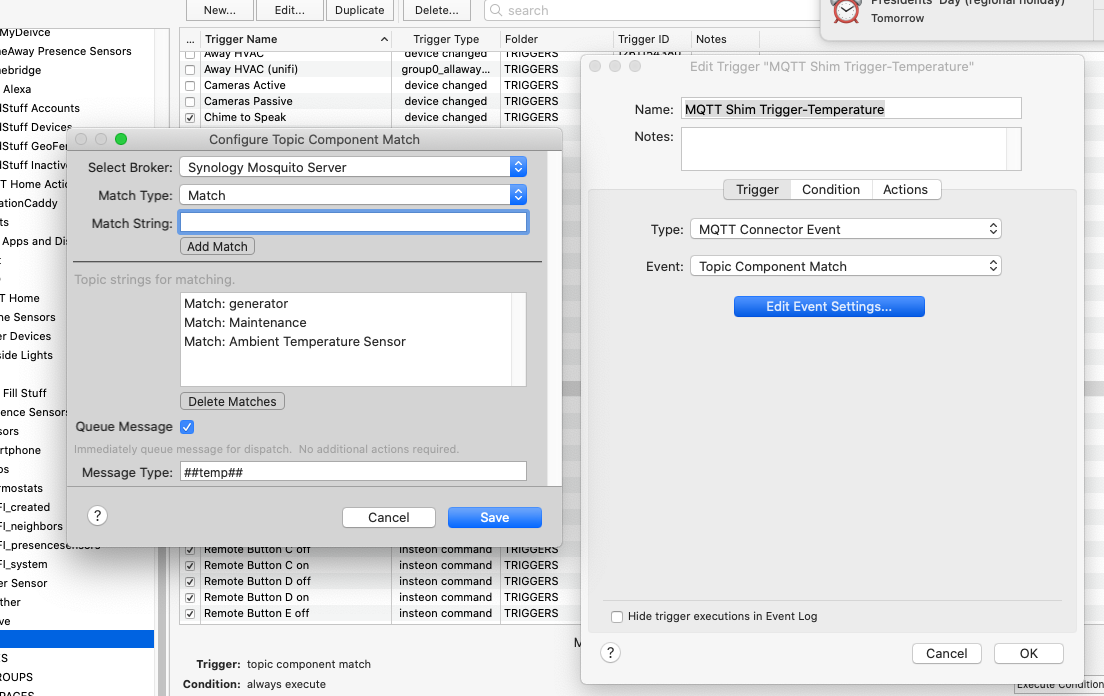

1. Set up trigger (Figure 2 and 3).
Match: generator
Match: Maintenance
Match: Ambient Temperature Sensor
type ##temp##

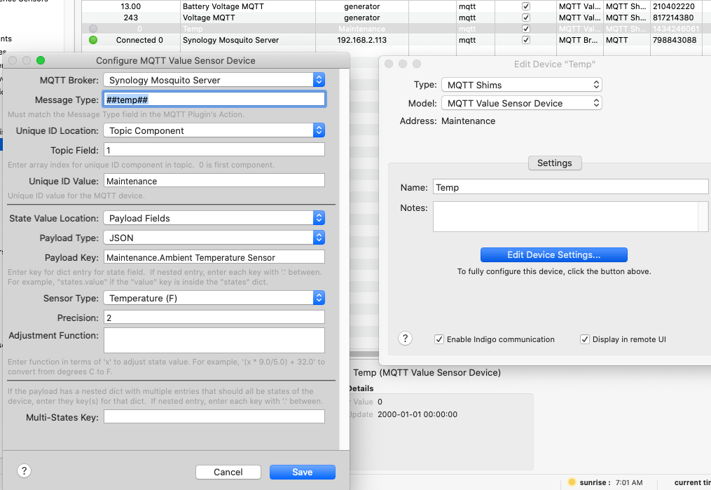

2.Shim Setup
a. Topic component should be the second in the list (according to the wiki) so I choose Maintenance and Field 1
b. Payload Key is likely where I am having problems. Based on Figure 3 the value it is 32 F
i. Since I do not have the payload visually as it is in the wiki I tried several options without success for the JSON payload
I so I choose several - Ambient Temperature Sensor, Maintenance.Ambeint Temperature Sensor - both do not work.
Match: generator
Match: Maintenance
type ##temp##

Re: Shims SetUp
The payload type for this is RAW like your last device. Program it the same.
I think you would still use this guidance from Joe for this one too:
Your unique ID for this device is "generator". Change that to field 0 and put in "generator".'.

Your MQTTLens output does not look like a JSON payload. I would use RAW like you did on your last device.

If you don't see curly braces "{}" in the payload string, it's not JSON.
You should be using Raw, but you get this error:
That's because the payload string isn't just the temperature ("36"), it's formatted: "36 F". Which breaks the string to float conversion.
Unless there's another topic that has JUST the number in it, you're stuck without this until I can figure out a way to make the plugin handle this case.
Is there also a topic "generator/Status/Line/Ambient Temperature Sensor/value"?
MQTT Shims Error Temp: update unable to convert '36 F' to float: invalid literal for float(): 36 F
Re: Shims SetUp
No there is not a topic with value like the others
Re: Shims SetUp
I have my system set to send JSON as numberics. I can send them as KSON instead. Let me see if that helps.
- Posts: 7830
Re: Shims SetUp
Then you'll need to wait until I can figure out if there's a way to deal with this situation.farberm wrote:No there is not a topic with value like the others
- Posts: 7830
Re: Shims SetUp
I have no idea what KSON is.farberm wrote:I have my system set to send JSON as numberics. I can send them as KSON instead. Let me see if that helps.
