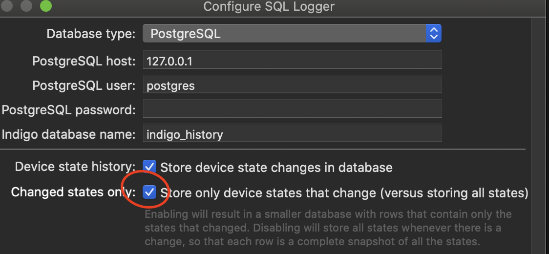

Do you have this enabled?
- Screen Shot 2020-02-14 at 10.50.41 AM.png (148.99 KiB) Viewed 3626 times
Mattias
Re: Trigger only on changes
Great, It might be that simple! I’ll check when I get home tonight.

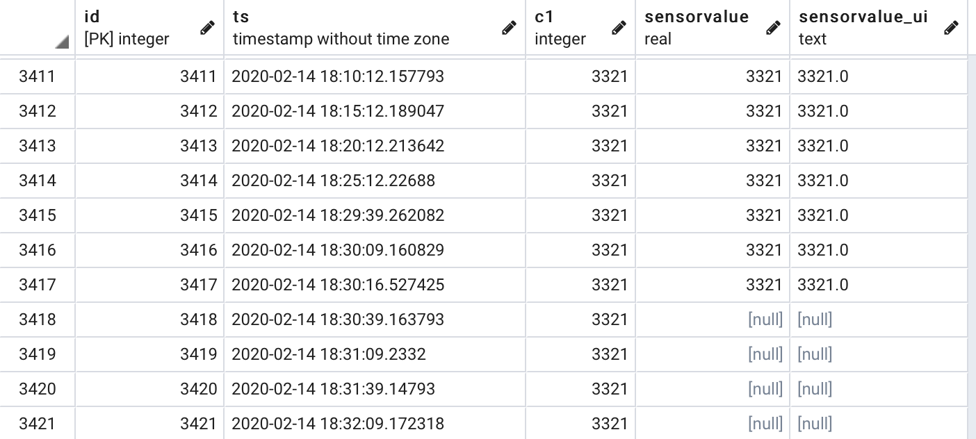

I changed the sqllogger configuration to store changes, but it's still logging every update.
(I did mess up my forum login and username, therefor the silence and my new login name which Matt help me set up)
- Screen Shot 2020-02-14 at 7.16.18 PM.png (111.31 KiB) Viewed 3499 times
and, the picture shows the data when I switched config to only log on device change.

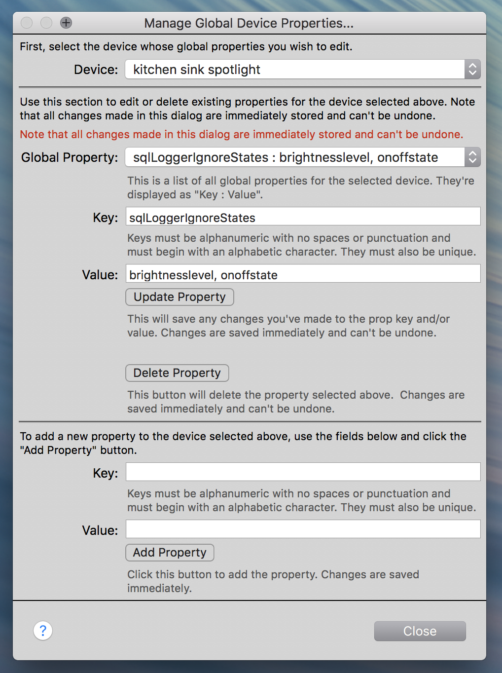

By adding a new global property to the device you can have the SQL Logger ignore updates for specific states. In this case new table rows are being added because the state id and state ts update every time, but you aren't interested in those state updates (there might be other states you want to ignore too, but from your screenshot those 2 definitely should be ignored). To have the SQL Logger plugin ignore those state use the Global Property Manager plugin to define a new key (sqlLoggerIgnoreStates) that's value is a comma separated list of states that will be ignored. Setting sqlLoggerIgnoreStates to * will ignore all state updates for the device. Note ignored state values will still be written to new device rows if there is a non-ignored state update (the ignore list only prevents triggering new rows to be added), but you will see far fewer new rows added to the table.
Here is a screen shot example of what it will look like in the Global Property Manager plugin. For key you will use sqlLoggerIgnoreStates and for value you will use:
id, ts
(not brightnesslevel, onoffstate like the screenshot)
id, ts
- Screen%20Shot%202020-01-27%20at%204.32.26%20PM.png (691.6 KiB) Viewed 3472 times

I tested the global property and it look like it's working. Brilliant! Thanks
