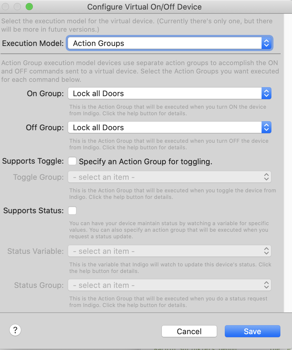

Also created an Indigo Virtual Device called "Locks," but have the On Group and the Off Group execute the same Action, which locks all doors regardless of whether someone says "On" or "Off."
Just not comfortable with anyone who can shout loud enough to be able to unlock the doors - even if outside the house but near an Alexa microphone. We have one near the front door, which regularly executes an Exit Procedure that locks doors and adjusts home settings as we walk out. Pretty certain I could yell loud enough through the door / window to trigger Alexa through a locked door.
Screen Shot 2020-02-19 at 12.05.54 PM.png (213.68 KiB) Viewed 3931 times
