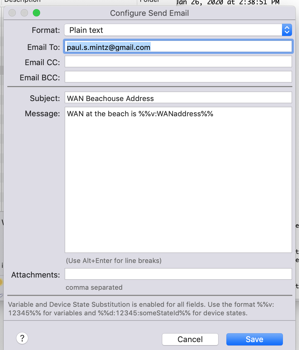

Re: Email variable value
Can you show me a screen grab of that action dialog? What field are you putting that in?
Screen Shot 2020-01-26 at 3.33.44 PM.png (195.25 KiB) Viewed 4190 times
I believe it has to be the variableID for device substitution, not the variable name. That's why the example is all numbers.

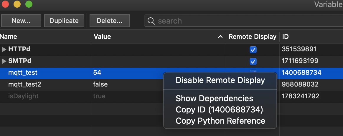

mintzps wrote:What do you mean by variableIID? How is that different from the variable name? How do I find the variableID?
It's the right column of the Variable list. You can get a copy of the number by right clicking on the variable in the list.
Screen Shot 2020-01-26 at 4.31.31 PM.png (228.36 KiB) Viewed 4157 times
jay (support)
Posts: 19232
Post by jay (support) »
Using names is a bad idea because the variable name can change over time which would break your substitution (or any scripts which use the name, etc). All items in Indigo have a unique ID that never changes over the lifetime of the object.

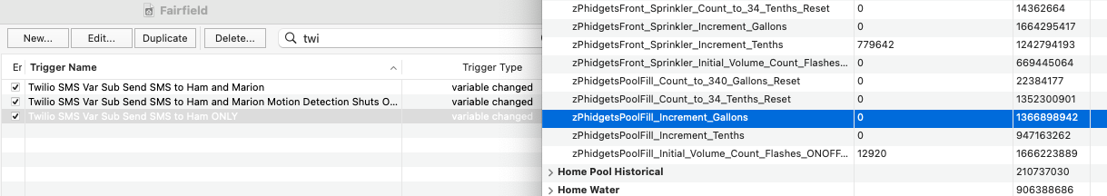

I used the %%v:1366898942%% convention in a new trigger--> send Twilio SMS, and it did not properly substitute in my variable, just showing exactly %%v:1366898942%% . Any ideas? New mac mini with 15.6.1 and Indigo 2024.2

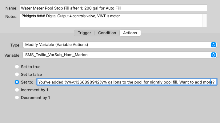

Thanks for the quick reply; family plans prevented my getting back. I think I may have figured out the issue.... I am using a variable change to trigger Twilio to send the contents of the variable, in this case a triggered text telling me that I have finished adding water to the pool, and is read by Twilio as %%v:<VARIABLE ID>%% format. That works perfectly. I believe what I have done is nest another instance of %%v:<VARIABLE ID>%% inside the variable text that is referenced above. It may be that Indigo does not see the nested %%v:<VARIABLE ID>%%.
Here are some screenshots, and the output.
Once pool fill is completed, this string is pasted into a variable that fires and Twilio sends a message. Note that I nested another var ID inside the text to be picked out by Twilio.
0901 Var Sub inside Var Substitution.png (45.08 KiB) Viewed 284 times

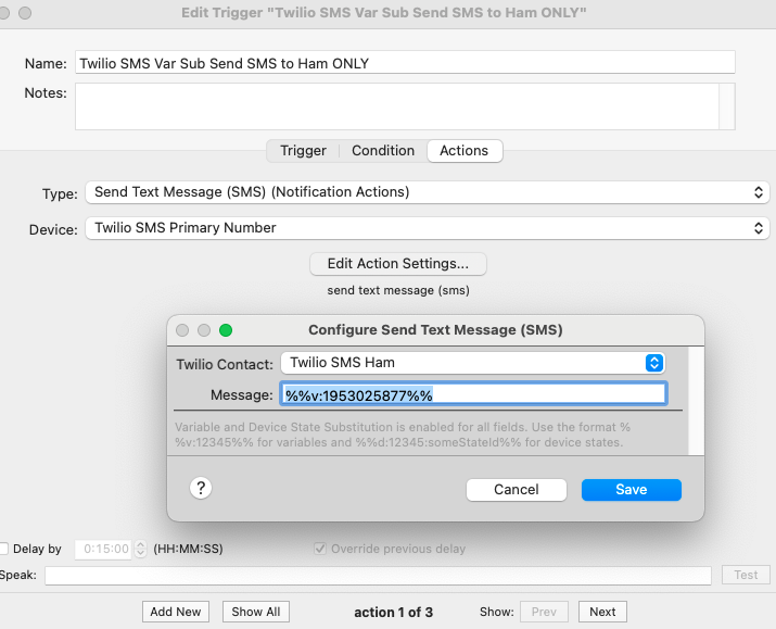

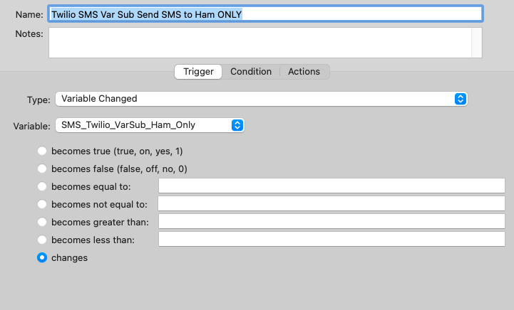

The Twilio trigger executes when a variable changes.
0901 Trigger Twilio.png (43.35 KiB) Viewed 284 times
Twilio reads the var substitution and sends message.
0901 Trigger Send Text.png (108.34 KiB) Viewed 284 times
Here is the second variable I am trying to nest within the first.
0901 Twilio Var Substitution.png (81.53 KiB) Viewed 284 times
I am guessing this can't be done, and the easy solution is to create another SMS to send the total gallons of water used as %%v:<VARIABLE ID>%%.
Yeah, unless the action that's actually setting the variable is doing the substitution, that won't work. I've never tested that.
