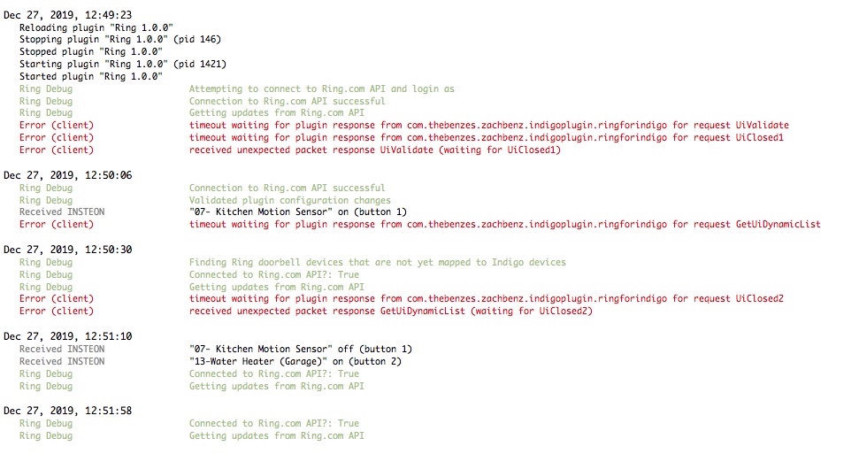

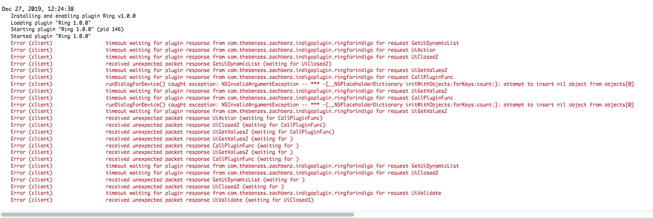

I could not get the RingforIndigo Plugin to work. I kept getting "Failure to communicate with Plugin" messages after entering in my Ring login. Attached are the error messages.
Nice try, but not working for me yet.

KSimmons wrote:I could not get the RingforIndigo Plugin to work. I kept getting "Failure to communicate with Plugin" messages after entering in my Ring login. Attached are the error messages.
Hmm... seems like it might be stalling out for some reason on the connection to Ring.com. Can you enable printing debug messages to the Indigo log in the plugin settings, or does it not even let you Save the settings? And this is under Indigo 7.4, correct?

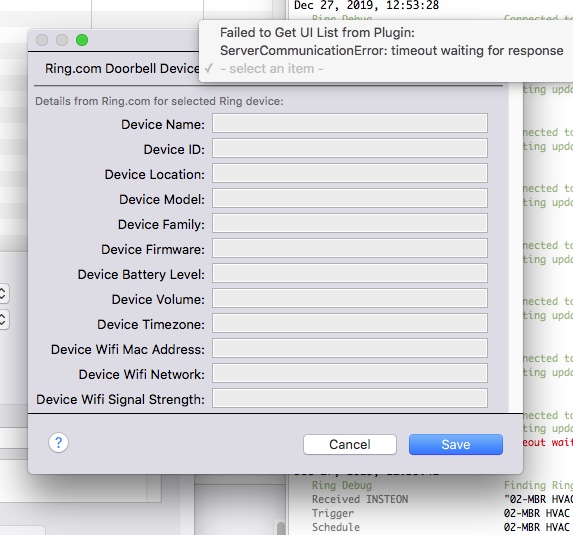

Yes, running Indigo 7.4. I also deactivated and removed the old previous Ring plugin, and restarted the server.
I turned on debugging mode and got some new messages, but the dropdown menu on the plugin is still not giving me any choices. See attachments.

KSimmons wrote:Yes, running Indigo 7.4. I also deactivated and removed the old previous Ring plugin, and restarted the server.
I turned on debugging mode and got some new messages, but the dropdown menu on the plugin is still not giving me any choices. ...
