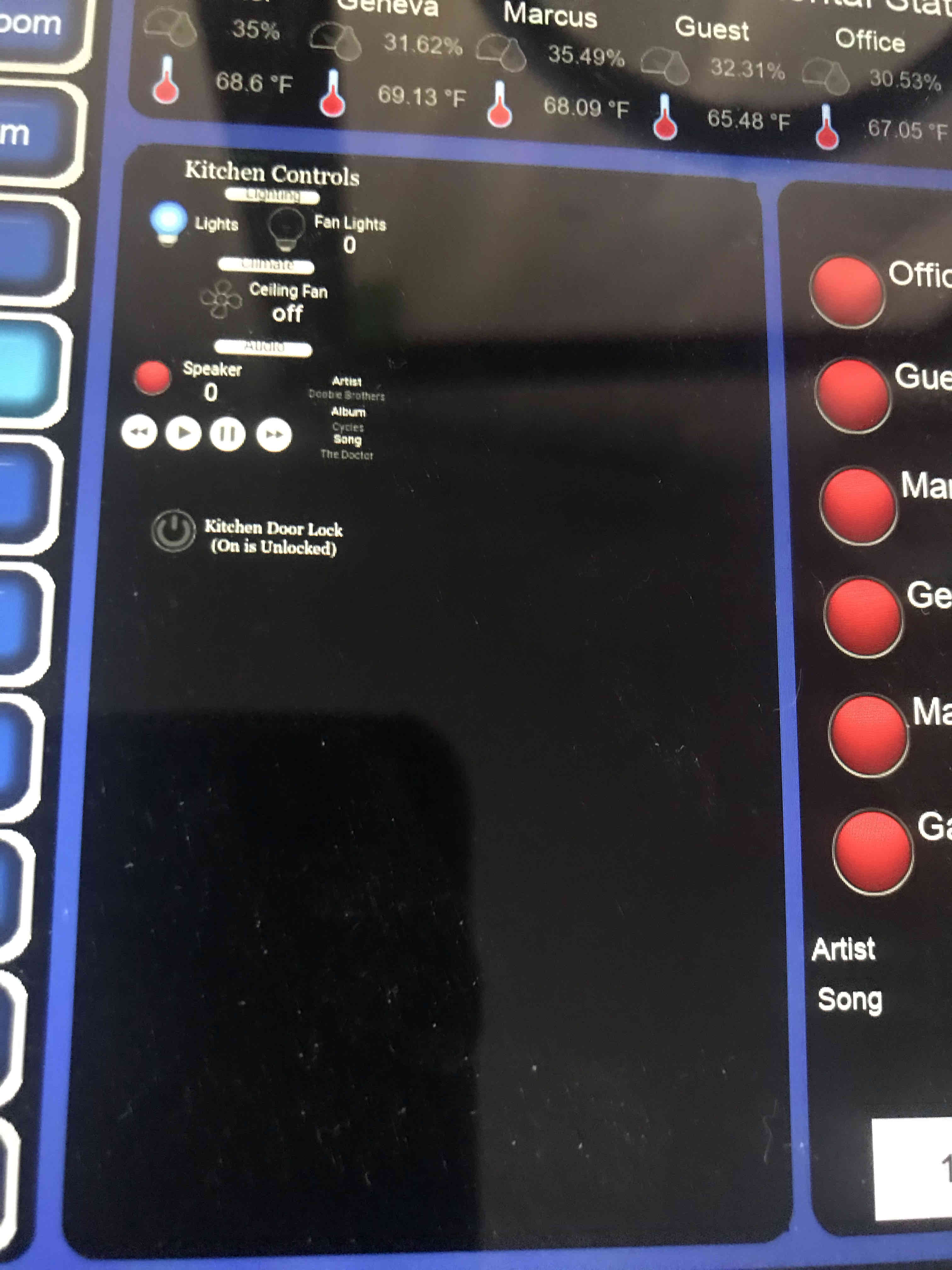

Adam, that worked great, I am trying to display the control page sized for my iPhone in a window in domopad. Currently, when it displays the web image it is very small despite making the variable image size the same size as the control page I'm calling. any thoughts? Is there a way to specify the size of the web page in the variable?
Gangotti
Posts: 92
Joined: Tue Dec 23, 2014 8:11 pm
Location: Las Vegas, NV
Re: Embedded webpage in a control page
Post by Gangotti »
Here is a photo for reference.

Gangotti wrote:Here is a photo for reference.
A very clever idea! I look forward to seeing how this works out
Domotics Pad simply loads the page into the view -- nothing explicit is being set as to sizing which likely means the server is not setting the viewport or else the Chrome WebView is not obeying it. Let me try to duplicate it here and see if I have any suggestions.
I can guess, but what are the specific sizes you are using?

Adam, the size I’m trying to display is 414 x 672. I have tried changing the number of pixels per inch in photoshop of the image and it yielded no change. The background image is 1920 x 1200
So the image is 414x672 as well as the background size of the control page being shown in the small window? I'll see if I can duplicate.
