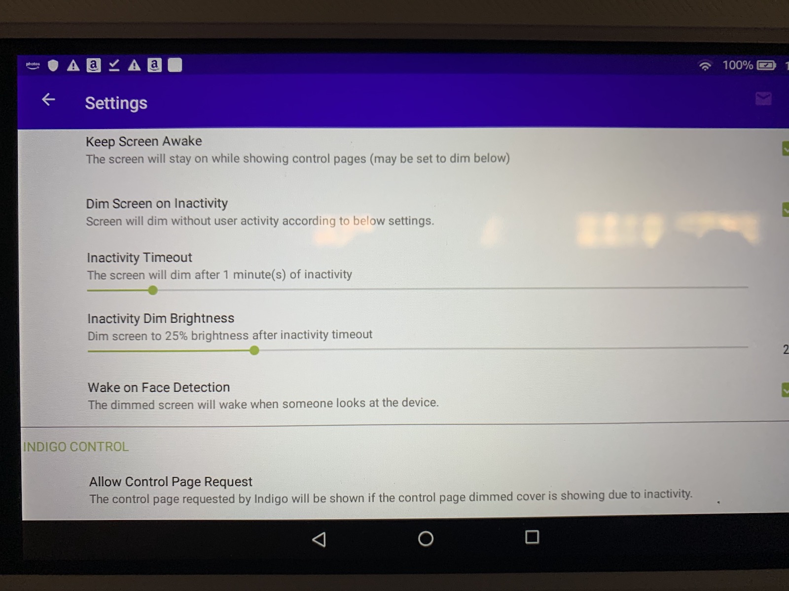

Followed your instructions... paired the tablet, adjusted settings as per your post.. set up a schedule to push a page every 1 minute... but it doesn't work.
- IMG_8539.JPG (278.6 KiB) Viewed 6231 times

Re: DomoPad plugin - device state change on inactivity
Does it work if you change the control page setting to allow it to change control pages any time the application is open? If not, then you may be connected to the old notification server... the best way that people have found to ensure they are on the new is to uninstall the application and re-install. Haven't found a pattern as to which OS version or manufacturers seem to hold on to the old connection... but the easiest way to test is to see if you can push a control page any time the app is open.
