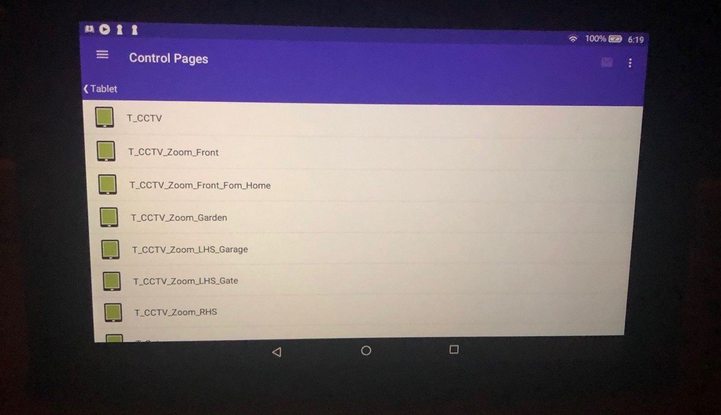

First of all, loving DomoPad on Fire HD8. Impressive work on App.
I do have one issue which I can't seem to solve. Almost every day (different times of day), whatever Control Page I have set seems to automatically be exited and the CP list view is redisplayed.
Ive attached a pic of state of DomoPad more often than not when i get home from work.
Obviously it's easy for me to reselect my desired CP again, however just wondered if it was something obvious that I've missed which could be causing it.

- domopad CP2.jpg (212.93 KiB) Viewed 6697 times
