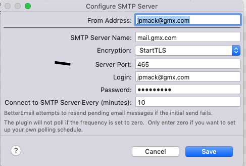

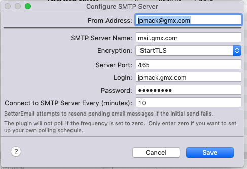

I have added a couple screen shot files, I don't see them in this area so do they get sent?
- SMTP.png (49.1 KiB) Viewed 4335 times
- Screen Shot 2019-10-17 at 2.16.25 PM.jpg (18.26 KiB) Viewed 4335 times

Re: Email problem
I've never used GMX, but I would try using ***@gmx.com instead of ***.gmx.com for the LOGIN.

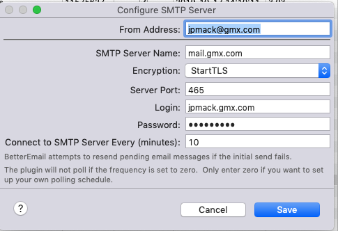

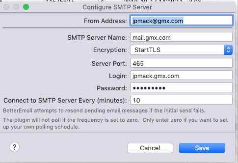

That was a real obvious one, but it did not change, still get "Better Email Error Better Email sending: SMTP server connection error: Connection unexpectedly closed"
The two screen shots are now.
- Screen Shot 2019-10-18 at 9.38.42 AM.png (48.77 KiB) Viewed 4323 times
- Screen Shot 2019-10-18 at 9.30.39 AM.png (52.25 KiB) Viewed 4323 times
- Screen Shot 2019-10-18 at 9.29.37 AM.png (49.83 KiB) Viewed 4323 times

Those were the settings from GMX tech support, When I change them to 587 & SSL I get " Better Email Error Better Email sending: SMTP server connection error: [SSL: UNKNOWN_PROTOCOL] unknown protocol (_ssl.c:590) "
Have no anti virus running and fire wall is " com.perceptiveautomation.indigo-server: Allow all connections"
Re: Email problem
Soooo, I went back to the settings from GMX Teck support and started with each port in there list, resetting Better Email each time, Port 25, STARTTLS, mail.gmx.com are the setting that actual work. I now have notification working, ( More than once ). Thanks for your help and suggestions, seems like a learning experience every time I open the hood, and that's not bad.
