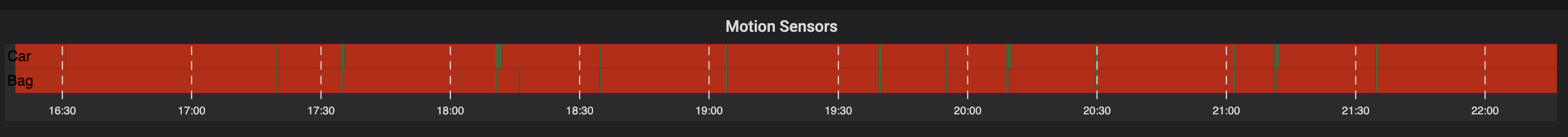

I have a mesh of 6 Pis now and all is working well generally, but I have a couple of devices that I use pibeacon to detect presence and automate actions when gone but they keep going down and almost immediately going back on line. I've added them to Grafana to keep an eye on behaviour and see that 2 of them, both beacons, are going down at the same time, which makes me think its an issue with pibeacon, not the devices, especially as each is normally seen by at least 4 Pis.
Any ideas on how to debug?
Screenshot shows them going off together, then appears the car takes a few seconds longer to come back Up at times. The bag is kept in the house, so seen by other Pis to the car.

3 and 4 minutes. I understand how that helps where only one Pi or at edge of detection.
But why would multiple pi's lose connection to 2 different beacons at exactly same time?

But looking at Grafana, yes, they appear to be 15 mins apart, 19:39:18 off, then on approx 50 seconds later. then off 15 mins later again etc. I see some constant on times for 30 mins, and then it can be good for 9 hours say.

I see that both devices went down for all rpis at 05:44 this morning, but no corresponding entry in the log files. I do see lots of these restartMyself entries for all rpis. Ths ones this morning seem to be more like 10 and 20 mins apart.

Sorry, that was meant to mean I no longer have the problem. On attached picture, up to morning of 10/16 you can see the small green lines in amongst the red blocks, that were the 10-30 second down times when the devices didnt move. Since then, these are no longer occuring. Only thing I did was tidy up some settings I think.. but all seems to be working now.
