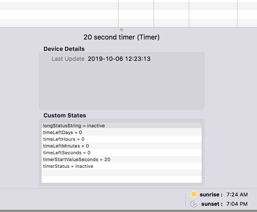

In the Main Window grab the divider above the Device Details section and drag upward to expose all of the Custom States defined by the device. So in the case below which is for a Timer device the stateIDs that could be used are longStatusString, timeLeftDays, etc. Not shown in that list will be the non-custom states, which are the ones built-in to the device type. So for example, an On/Off Relay device or an On/Off Sensor device always has a state of onOffState defined (which might be what you are after). Other examples, a dimmer device always has brightnessLevel. You can also log all of the states to the Event Log by choosing the Plugins->Open Scripting Shell menu item then pasting in something like this (substitute in correct device ID you are interested in for someDevIdHere):
indigo.server.log(unicode(indigo.devices[someDevIdHere].states))
Screen Shot 2019-10-06 at 12.29.59 PM.png (169.21 KiB) Viewed 4667 times

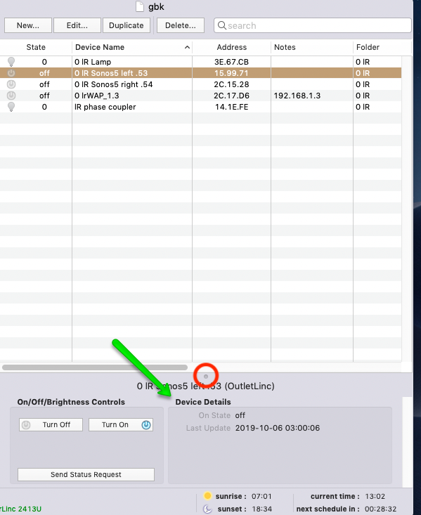

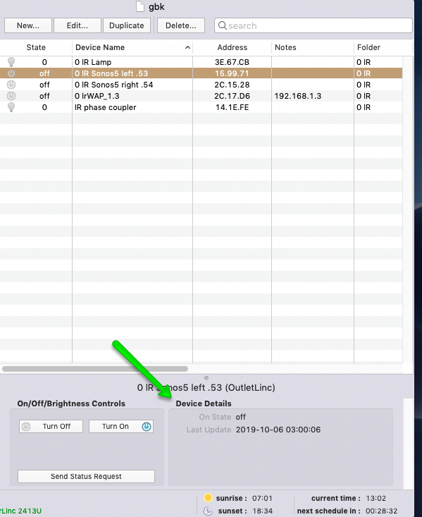

This sounds like what I need. However, I can't find the window over Device Details. (the attached shows where I'm looking).

Click-drag on the thumbnail grabby thingie (the small gray circle) that is directly above the "left .53" and drag up – it will expose the device states view.
Re: Device state - not working
You need to drag up on the "dimple". See the image.
But in this case, you don't need to see what's in there. This is a standard on/off device. As I stated above, the name of the state is 'onOffState'.

small bug: in the Device Details window, onOffState is written as On State (which I just discovered, does not work).
